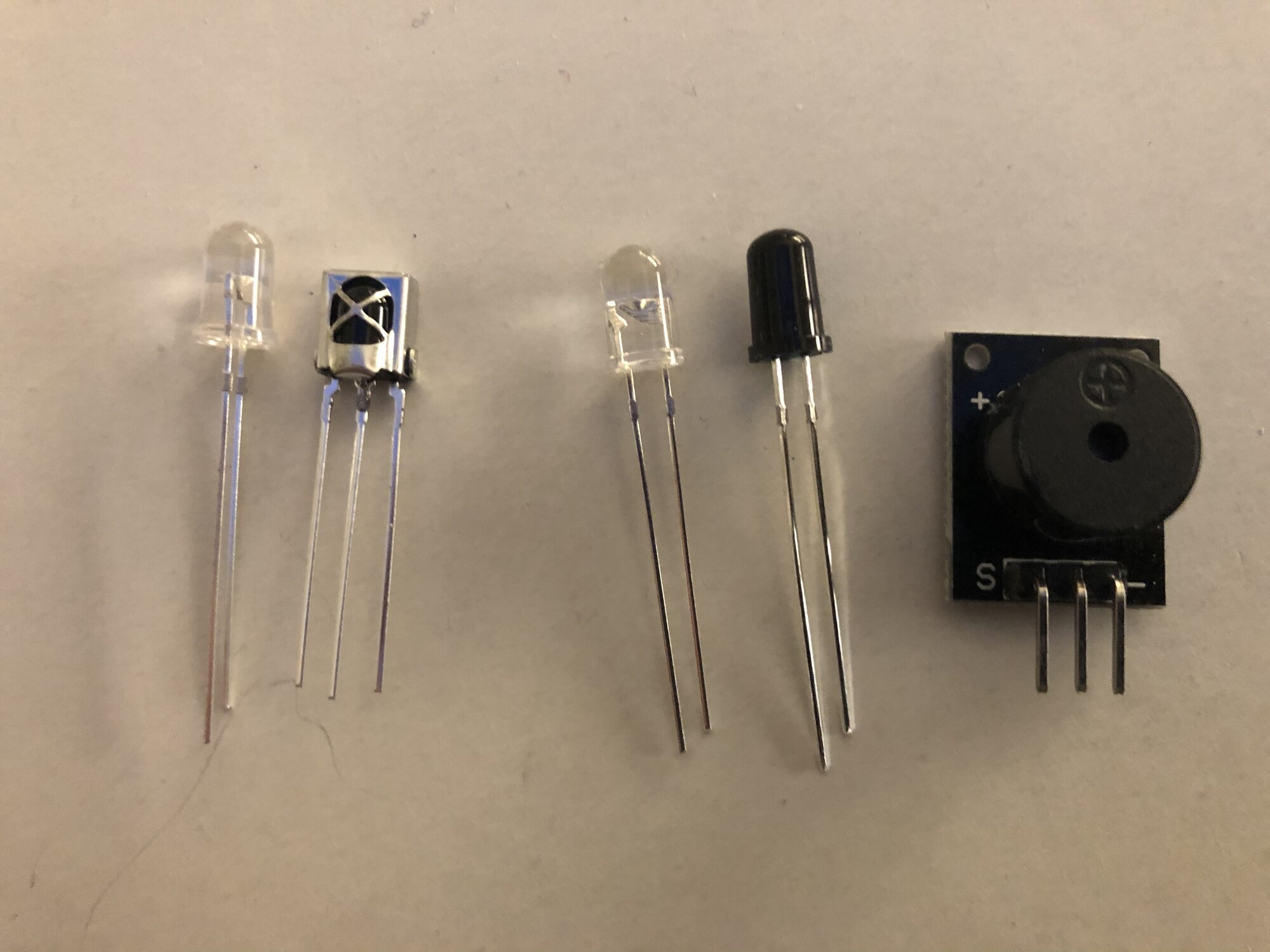

I bought a sounder too to tick.
I was waiting for you to send me back that link that didn't work. When you send the link, make a test if its working in your side, immediately after you send the message. Then you can press the "edit" to change the link if is still not working.
Officially they are called buzzers and not sounders. Is a keyword that works in google and on ebay or any other online market. I am using the correct one because I learned to respect these keywords over the years and they just work. So get in habit to use them correctly as well. Its how I do things and it helped me.

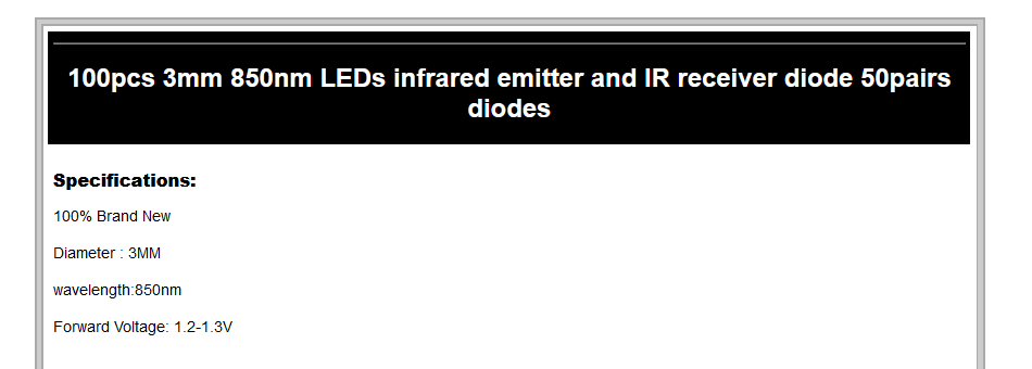

These are the IR leds and receivers I have, it it helps : https://www.ebay.com/itm/100pcs-3mm-850nm-LEDs-infrared-emitter-and-IR-receiver-diode-50pairs-diodes/323206187341?ssPageName=STRK%3AMEBIDX%3AIT&_trksid=p2060353.m2749.l2649

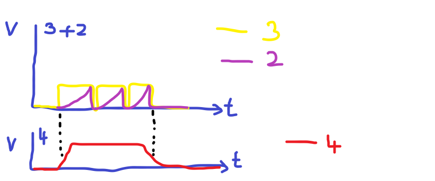

I have studied your last video carefully and if my eye-sight does not deceive me you are using the 555 as a 'sawtooth' voltage waveform generator at pin 2 - the purple one in my attached diagram. There is too a square wave output of the same period from pin 3 - the yellow waveform.
The 555 is kept in the reset state - outputs pin 2 and pin 3 - at 0V when the reset pin 4 is kept at 0V. Upon receipt of a series of data pulses 0-5-0-5-0....V from the Rx data pin, the diode-capacitor network will charge up until pin 4 crosses the threshold to become active high. Then the 555 is no longer ins reset state and oscillations at pin 3 and 2 begin. When the data pulses stop, the capacitor discharges until pin 4 becomes active low and the 555 is once again in the reset state and oscillations stop.
Pressing the button on the remote will then produce a repetitive pulsed output with almost 99% mark to 1% space ratio and a sawtooth waveform of the same period until the remote button is released.
The circuit is not quite correct for interface to your LM3915 pin 5. What you want to happen is a voltage to be input to its pin 5 which is 0V when the remote is not in use. When the button is pressed the pin 5 voltage must grow from 0 to 5V and remain at 5V until the button is released. Upon release of the button the voltage reduces to zero again. See my second diagram.
We can fix this.
