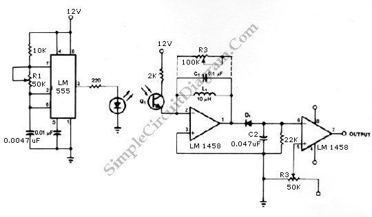

- Give me your best IR remote circuit that you can think of/know of, and that is working optimal at least 4meter distance.
It's the next thing I really want to try. My reason and my desire is to use multiple (probably 2)remotes with a IR led.
I suspected the RF boards will be problematic but now I know why ! That is called experience, even if it failed on me.
Can you help me on that?
Oh...and if it helps you in any way. my american friend had build (not like you) only the RF transmission + the 555 circuits for both Tx and Rx. For him it worked perfectly. But for me it did not. My point is that even if its working for you there, is not necessarily to work for me the same. Ive already experienced it and im telling you to know how things are. Another point I want to make with this example i mention, is that we must try it until it works, because if we try enough times, it will work. Im talking about the IR experiment we are about to make.
Im thinking to start making my own design but.... im really new to it, so Ill handle it to you first.
This circuit I found the other days. I want to believe it will behave the best and in my parameters I want it as I enunciate it at the start of this new post here.
If you have your own design, Im happy to see it. I kind of finding this circuit, that is a bit hard because of the double power supply I must insert, and I very much want to avoid that. And also at 5V, and not at 12V as this is offering.
But if no alternatives works, then this is the backup.
