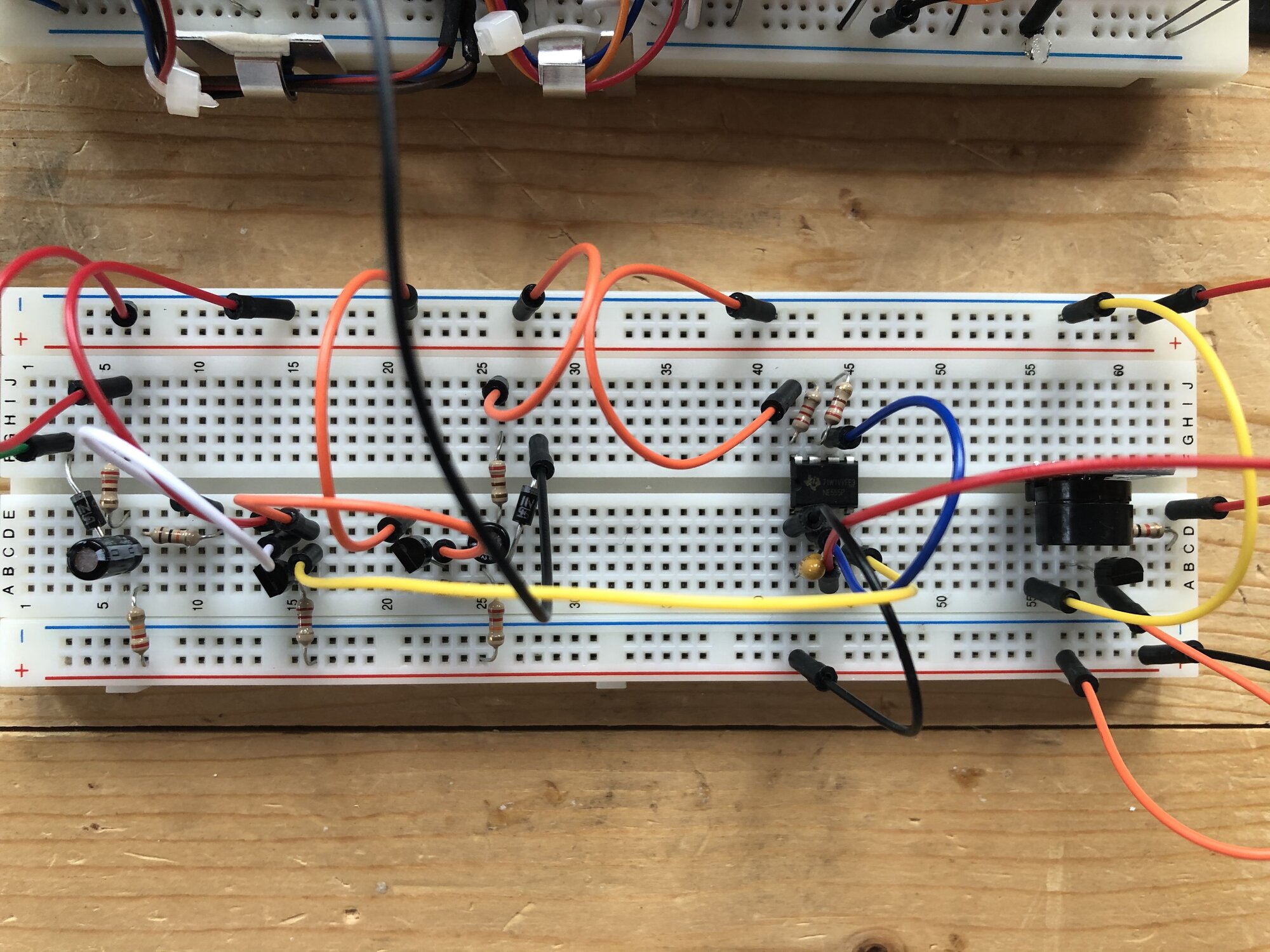

q12x I had a go at putting together the circuits I posted this morning and then trying them out on version 1 of my IR proximity switch which is similar to your wings. I only made up two inputs to monitor the state of two of the yellow LEDs ( the 5th and 6th ones counting from the bottom). The differentiator detects the rising or falling edge of the switching pulse, and as wired on the breadboard at the moment it will detect and produce a beep only when an LED turns off. If you watch and listen carefully you can see how it performs.
The outputs of the comparators in version 1 fade and oscillate when the hand is moved slowly or remains still near the threshold points for LEDs 5 and 6. This affects the pulse waveforms which I highlighted in green and therefore the one which controls the 555 using the trigger input at pin 4 - you can hear the effect on the beep and illumination of LEDs 5 and 6.
In version 2 there is no fading or oscillation because I introduced some positive feedback/regenerative switching (hysteresis) at each of the 8 comparators, used some Schmitt trigger circuitry and employed a sample and hold technique which I described earlier ( S, P and Q). As an aside, the ruler LEDs are driven by the state of Q.
Much more work is required with the ideas I sketched out this morning to produce a click effect as good as in version 2. Alas, it will not be by me because I have achieved a satisfactory click effect in a different way and I don‘t have the motivation.

q12x Good morning. I was looking for technical data on some 940nm ir leds and photodiodes I bought off Amazon only to discover that the photodiodes are in fact photo transistors according to several reviewers of the products so I will not be using them for my next sensor array.
I managed to find some 940nm photodiodes and 890nm LEDs on RS - see link and data sheet. This black photodiode has an integral daylight filter. Might be useful for your sensor too. There is a nice graph ( Figure 6 ) in its data sheet showing the relative sensitivity of the photodiode which shows it falling off rapidly towards the visible part of the spectrum.

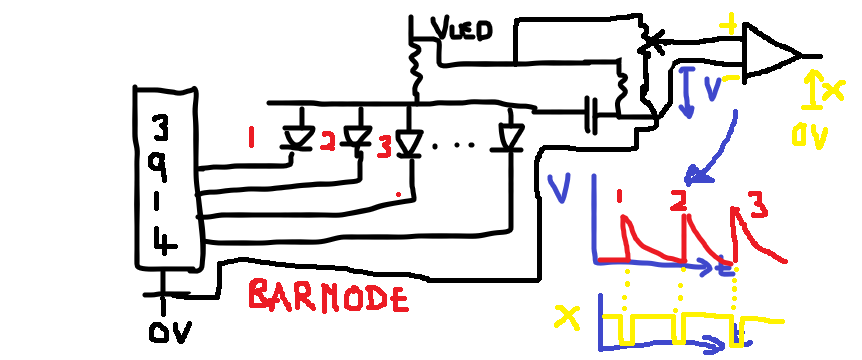

q12x Good morning. I thought of this idea to generate a click pulse whenever an LED turned on. (You would need a second op amp comparator to provide a pulse whenever an LED turned off, wired like the one I have shown but with its inputs (+ and -) reversed). The LM3914 would have to be in bar mode. The idea relies on the LM3914 LED outputs being constant current drive signals to each LED. Each time an LED turns on there is then a step up in current I through the common resistor which connects them all to Vled. Thus there will be produced across this resistor a step in voltage which the CR differentiator across it will turn into a short downward pulse V. During the downward pulse the differential voltage into the comparator will be less than 0V so the output will be 0V as shown by the waveform X. The X waveform can gate the click on and off.

- The sound problem, the ticks. Mister @marconi , you did very good job and I referenced your work when I thought about this subject. Your doing, for me is an idea and a way to do it. So you helped my final decision even if is not the same as yours. I think I am more happy to build the sound ticks over another lm3914 in paralel with the existing one for the wing leds. I will basically have to drag 3 wires for its module: the signal to pin 5, from the other IC pin 5 as well, and the power pos and neg wires. Thats it. Very compact and robust.

q12x I too am very pleased to read about your many accomplishments with this challenging project. I will look at the video as soon as you post it. I think you and your work demonstrate what Voltaire said:
No problem can withstand the assault of sustained thinking - philosiblog - https://philosiblog.com/2011/12/02/no-problem-can-withstand-the-assault-of-sustained-thinking/
I think the idea of using a second LM3914 is true genius - so simple, so reliable, so effective, so economical. (I wish I had thought of it!)

I have made a an exact replica of my 850nm IR sensor array but using 940nm photodioes and 890nm LEDs. I have connected it to my version 2 and it does indeed appear less troubled by daylight and artificial lighting but not completely. I have not pulsed the 890/940nm sensor yet which is the major theme for Version 3. I thought I would study the signal from this sensor first using my oscilloscope for continuous and then pulsed IR. I want to 'see' the nature and magnitude of the interfering IR signals and the effect pulsing has.
I have not made up my mind yet about whether to have 8 comparators again examining the sensor signal acting as a flash (ie fast and the full voltage range at the same time continuously) analogue to digital voltmeter/converter or whether to only have one comparator and feed it with a ramped/stepped voltage reference and to then sample the comparator output at time/voltage intervals. The former would use something I know works; the latter would occupy less space but would require time and effort to design and test and be a distraction from the real challenge of tackling the interfering ambient IR problem.

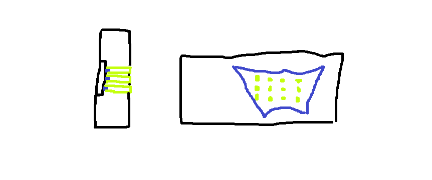

Why do you mention the light pipes? I am aware of their existence, but i did not know the name of them if i wanted to search them. So the name is new for me.
What should I do with them?
I thought you could put a cover over the board with the modules on. But that would obscure the LEDs. What you could do is use the light pipes to take the light from the LEDs from the wings moduleto holes in the cover so they could be seen. The light pipes have flat or rounded ends. You as an artist could then design and draw the wings on the cover around these light pipe exit holes.
