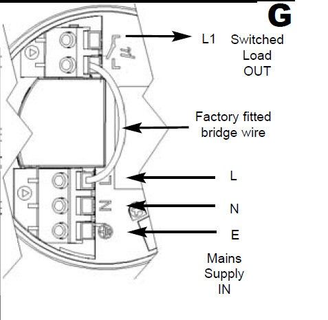

Hi,
Just said to someone on the phone, yeah I can do that for you, 10 min job, no problem then just gave it an ounce of thought and realized I probably cant.
Heres the situation,
Standard pull cord switch on ceiling, wants it swapping for a PIR.
Can I do it without doing anything to the wiring?, probably not im guessing... I need a neutral done i...
[ElectriciansForums.net] Is this possible?
Or can I run both wires from the switch into the line and neutral at the bottom and bridge across, or will that not work?
I doubt it's accessible to be honest... Just thinking about it, the bloke also said he has a heater light unit old flying saucer thing, I bet it will be too much to switch on the pir.
The bloke wants the pull switch taking out as it reminds him if his wife who died of cancer last year every time he pulls it as she used to get up in the night and he would hear it.
How will it be too much for the pir, you could use one to turn off a supply from a sub station if you wanted to.
Use Contactors etc (dont know how big contactors go upto or if name changes)
