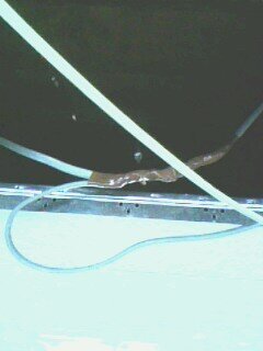

Hi everyone,
I would very much appreciate your feedback/comments regarding this electricial install to help my cousin who has been ripped off and potentially could have put her life at risk!
She has recently had new decking fitted in the back garden and a family friend of hers who I kind of know put in the electrics for the outside lighting. This kid has being doing electrics since leaving school (approx 10years) and I know the firm he served his time with and I have come accross his work before!
He has installed outside lights to the decking in 1.5mm and took the feed straight from a kitchen socket under the sink and cut the earth out. He's then run it to an outside two gang switch (to which only one gang was needed) he then took the feed out of the switch in 2.5mm and fed every metal* light fitting reducing the cable size to 1.5mm then back to 2.5mm. He has cut off every earth at every connection point terminated in connectors and left them out in the open...yes in the open! He has made so many connections in connector blocks and failed to connect the earths from the fittings.
I had to go round earlier to see for myself as I did not believe that he had done such disgusting work when my cousin told me. I have asked for her permission to put these photos up and would like some feedback off other electricians.
I have uploaded some photos to show you how bad this install is.
Thanks

Got his name and number? I would like to ring him up and do ME a job and i'll ram a screwdriver into his head and then i'll be put away for manslaughter rather than let this freak free to put someone else's life at risk.
This is not funny, at all,by any means he should be named and locked up for a minimum of 6 months and removed from any electrical qualifications he MAY hold.
And part P IS useless this post proves it!
That is disturbing... What is colloquially known as common sense should dictate that live exposed conductive parts should be covered never mind BS7671...
Burying T&E??? common...
and are the fittings even IP rated?

seriously this so called sparky hasnt a clue or doesnt care even if he had it on a RCD it wouldnt work it needs a earth and special location

either dont complain or report it this what is shown is a life threatening example bit of rain little kid and electrics makes for a distaster
and why would an RCD not work?...exposed-conductive-parts?..yes?......a potential earth path?..yes?....

The only thing I can see done correctly about that install is the fact he actually pushed the boat out and used 2 screws to hold the patress box to the wall......
I have to agree with all the rest, awful and downright dangerous. Some people should have their tools taken away. :90:
I'll bet he didn't install that box...
