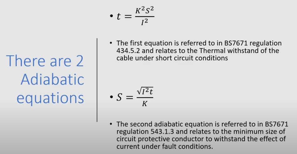

could someone tell me how to calculate the actual disconnect time from a log table and where I can find this table for a 6A RCBO made by British General. I need this to get a meaningful CPC CSA using the adiabatic equation.

Calculating CPC size using manufacturer's data usually gives a much smaller min. CPC than those listed in table B7, but not always. BG and Contactum, when asked, gave identical data (which I suspect comes from the product standard rather than their own tests) which, when run through the adiabatic, gives the same results as table B7 for the higher 3-6kA fault.

Take a look at the fault curves in appendix 3 of BS7671. For type B and C breakers/RCBOs, if it meets any permitted disconnection time, even 5s for distribution circuits, then it disconnects at 0.1 seconds (or faster). There is no middle ground, as above a certain current the magnetic trip will operate and will disconnect instantaneously. For example, you can't make it disconnect in exactly 1 second.
As you are presumably using a B or C type breaker/RCBO, use the fault current at the origin of the circuit for the calculation. For these devices, let through energy tends to increase with fault current, and fault current is greatest at the origin. This is the most onerous point in the circuit.
