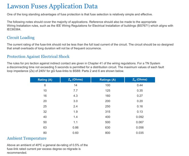

One little word of warning, if you are measuring your Zs very close to a transformer, you may find you get false (high) readings due to the impedance of the transformer windings. I have done a little spreadsheet that will calc the Zs at the incoming terminals of a switchboard fed by a transformer. Let me know if you would like this.
And you think the reading is not realistic because of the transformer ? How would you recommend putting a resistance on the circuit bearing in mind it's an open occupied hotel ! Sorry I've never come across this problem and not really tested bussbar
Accurately measure some 1.5 singles to say 0.10 ohm. Take a Zs at the busbar with meter leads only then take another reading with your known resistance in series with one of the meter leads and then deduct the 0.10 ohm and see if it differs from the original reading. This often works if you are very close to the transformer.

For what OCD? There may be other means of over current protection that allow a Zs of0.45 (HRC Fuse?)

Many thanks. Very clear!
