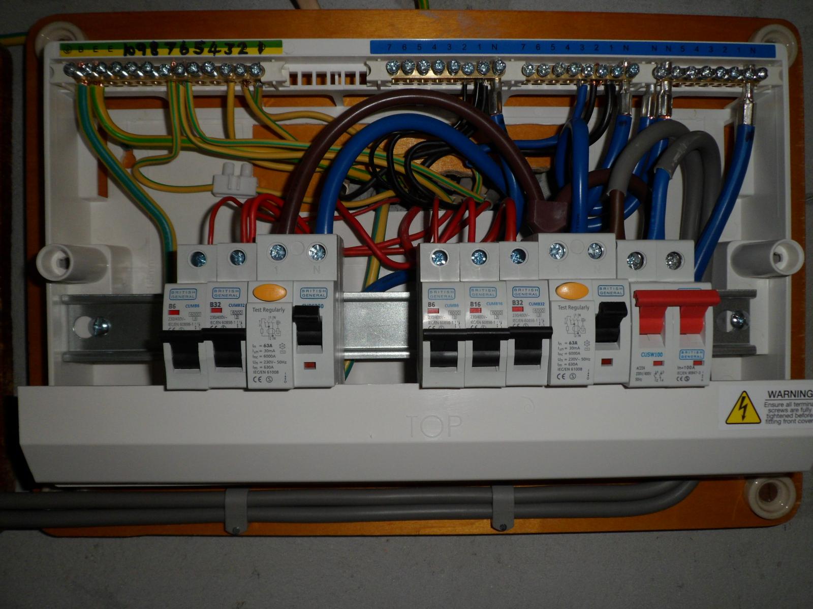

Put this in today, I hope it doesn't burst into flames.:tongue3: Didn't have the time to faff about and get the cabling 'perfect' as I had so much to do today but I think it's ok. With the BG boards I generally 're number' the earth bar as to me it's illogical having the CPCs running in the opposite order of the neutrals,I'll miss the insulated CUs. Sorry about the
poor photo. :)

So how is running the earth conductor in same hole going to stop this rise in temp.? I was always under impresion eddy currents were concern in line and N conductors in >200amp installs. Please copy n paste the reg on here fir those of us who dont have a big book to hand
Blimey ,
One minute giving me brutal criticism and going well overboard about a perfectly good,safe and totally compliant installation and now you want to disregard certain regulations. :juggle2:
you can put the cpc in a separate hole as long as it's a square hole. by the time that eddy has negotiated the corners, the fault will have cleared. :behead:

Someone said about the difficulty of making a really neat job when reconnecting older wiring into a new CU,here's a 'before and after' from a few months ago I know there's a connector in there,one of the CPCs was too short. :)[ElectriciansForums.net] My last 'non Amd 3' CU Install.[ElectriciansForums.net] My last 'non Amd 3' CU Install.
Edit - The interesting think about this was that circuits 2 and 3 in the old Wylex [from the right] were the two ends of the same RFC, it had been like that for 45 years !
Someone said about the difficulty of making a really neat job when reconnecting older wiring into a new CU,here's a 'before and after' from a few months ago I know there's a connector in there,one of the CPCs was too short. :)View attachment 31040View attachment 31041
You've stripped the sheath on the blue tail 1/2" too far back.
Rip it all out and start again.:33:
