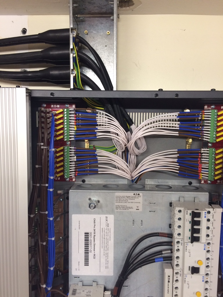

Put this in today, I hope it doesn't burst into flames.:tongue3: Didn't have the time to faff about and get the cabling 'perfect' as I had so much to do today but I think it's ok. With the BG boards I generally 're number' the earth bar as to me it's illogical having the CPCs running in the opposite order of the neutrals,I'll miss the insulated CUs. Sorry about the
poor photo. :)

id like to see the dimmer. was it in a theatre?
It's in a school hall, though it's the same as we fit in smaller theatres at the moment.
The job was a little behind due to waiting for the schools contractor to run (bodge) the supply in. So I ended up going back the day of the first performance of their nativity to get this fitted and a bar up as quickly as possible. We're going back to complete on the 4th I think, I'll get more pics then if I remember.
[ElectriciansForums.net] My last 'non Amd 3' CU Install.
[ElectriciansForums.net] My last 'non Amd 3' CU Install.[ElectriciansForums.net] My last 'non Amd 3' CU Install.[ElectriciansForums.net] My last 'non Amd 3' CU Install.[ElectriciansForums.net] My last 'non Amd 3' CU Install.[ElectriciansForums.net] My last 'non Amd 3' CU Install.

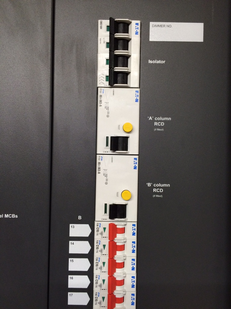

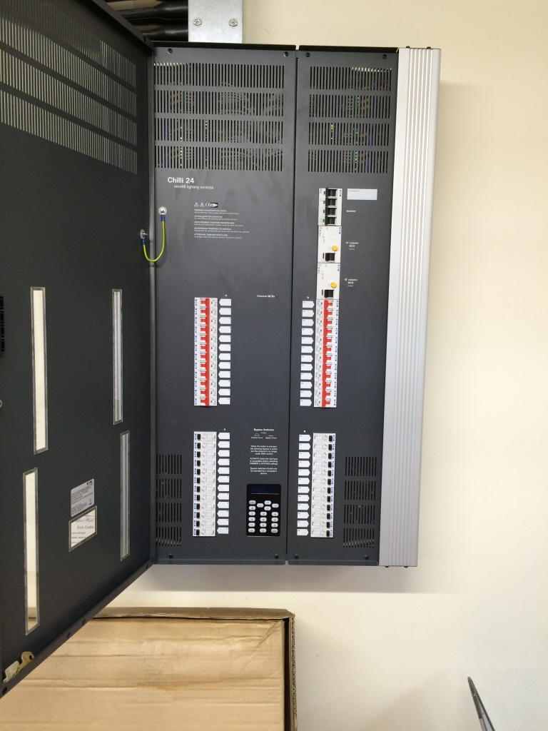

The dimmer is a 24 channel 'bypass' dimmer. It has switched to bypass the dimmer circuit for each channel to provide hard power to that outlet.
Each channel is rated for 2.4KW and protected with a 10A SPSN mcb with an RCD per bank of 12 channels.
The maximum incoming supply is 80A TP, but most installs would be fine on a 32A or even 20A TP supply.
As you can probably tell the company who make them have been absorbed into the great EATON empire!

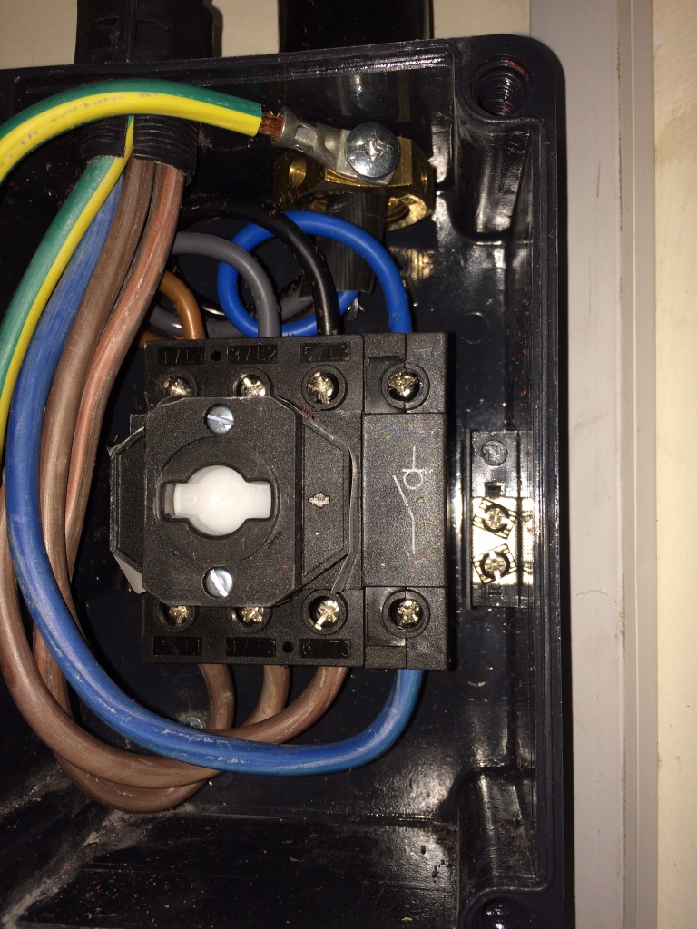

The isolator is the supply as provided by the school's contractor (NICEIC's finest), spot the obvious mistake!
The outgoing flex in flexi conduit is my temporary bodge to get it going for the school nativity play, it'll be replaced when we go back to finish off.

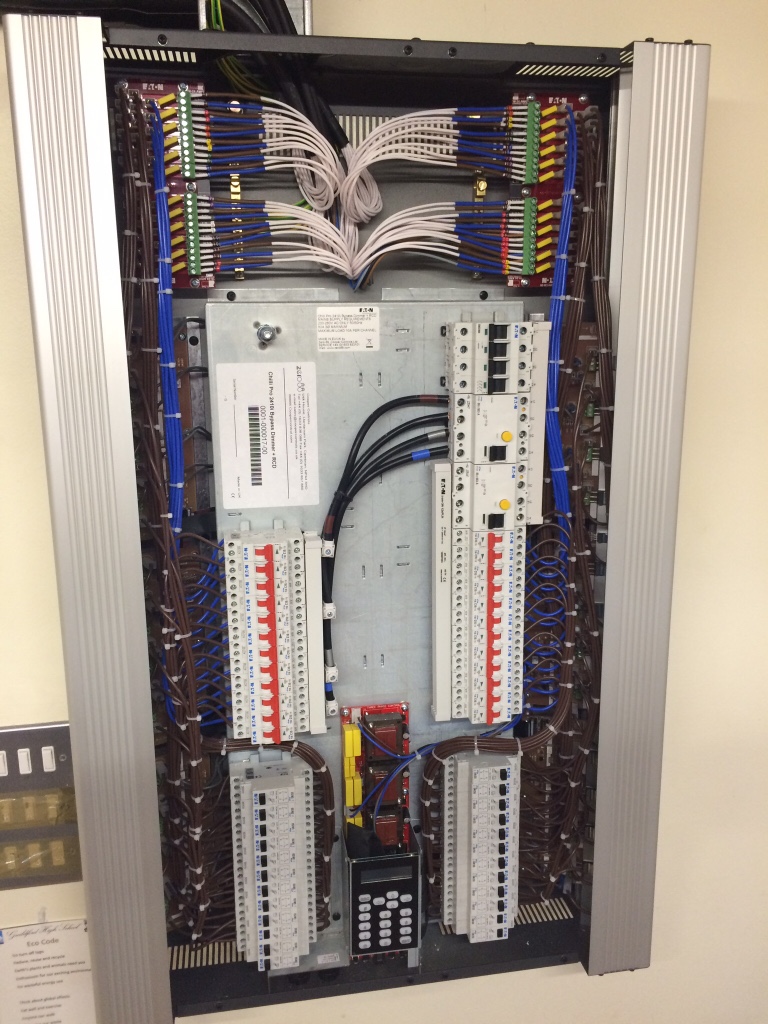

Let's see how many errors we can spot in one of my boards. This is a second hand board which I've fitted in the warehouse for the test bench and work bench.

Looking outside, the SWA is not straight not one cable cleat in sight.? (just saying)
At that particular point in time it dropped down to a coil sitting on the workbench below the board ;)
The supply board is immediately to the left of this one and the cable now does a neatish loop up to it. I think it's cable tied to the upright scaffold to the left (which is the structure of the workbench and mezzanine above)
As I said its our workbench so didn't exactly get tip-top tidying
