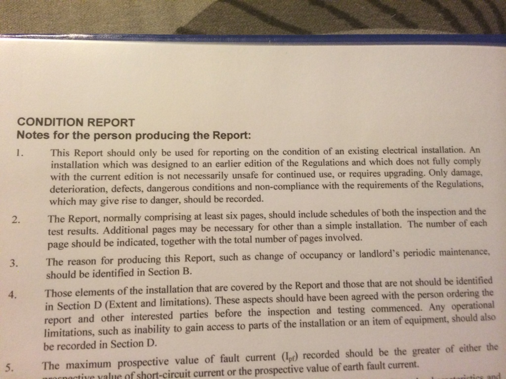

Plastic CU, no code on the next EICR as complied at the time of installation.
Cables in escape routes, no code as complied at the time of installation.
The regulations are not retrospective.
They aren't retrospective, but it is completely irrelevant whether something complied at the time of installation. You can't say that something is less dangerous if it complied before but more dangerous if it didn't. The danger - perceived or otherwise - would be exactly the same.

I personally would C3 those items. Not the cables colours though unless a harmonization label was not installed.
They do not warrant a C3 code, item 1 in the below image explains all.
[ElectriciansForums.net] new reqs[ElectriciansForums.net] new reqs
Having one word wrong on a label or solid green sleeving are not in any way dangerous or able to give rise to danger.
But most old installations won't have a new colours label unless they contain both wiring colours.
Fair comment with evidence. I will still include them in our reports but goong forward probably not code them. You cannot be wrong if you include it but you could be seen as wrong if you do not.

Generally, I would apply a code C3, for instances where an installation complied at the time of it's design/construction, but does not comply with the current requirements.
For instance: cables concealed in walls without an acceptable method of additional protection, socket-outlets intended for general use by ordinary persons, circuits of a location containing a bath or shower, not provided with RCD protection, time delayed RCDs set to 5s, etc.
With instances where conductors have not been correctly identified, such as switch lines, where earth sleeving has been omitted or a lable indicating two colours of wiring are present, I would just rectify, and not bother applying a code.
At risk of going off a bit. To gain RISQS (formally Link-Up) approval you will certainly require NICEIC membership. We have both.
I would also do exactly as you said above. Anything that did comply that now does not I would C3. Unless of course it was a little more serious as I am sure wevall would too. There would be no way in reality to verify when the installation was designed or installed.
