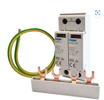

I’ve attached photos and the pieces that I believe should go there. One is too big.

From the first image posted, the only thing we can say is it’s untidy.
We now know the SPD is correct, taking the earth from the din rail clamp.
We now know it wasn’t a full rewire. The kitchen was already done, so it’s been a lack of communication as to which circuits were rewired. He may have priced the job on so many circuits, then on site found there were extras.
If this board on the picture was to be given an EICR, the worst outcome would be a C3. In which case, there is no requirement to have it redone.
It is not immediately dangerous, nor potentially dangerous.
Visually, the plastic board below is a definite C3, and the one hanging to the side would be C1 if it’s still connected.

I have only fitted 1 Hager SPD board and it was supplied with no earth lead just the galv bar which links the 2 earth terminals and is fixed to the metal case by screws or rivets (can't recall)..It seemed odd to me but there was no further info in the paperwork. Connection to outgoing side of mainswitch was the offset busbar as shown in your post.
