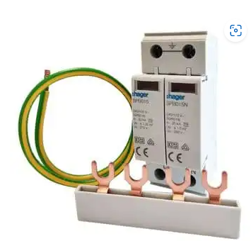

I’ve attached photos and the pieces that I believe should go there. One is too big.

@westward10 my understanding is that they look like this - and I'd expect to see some glimpse of the CPC .
