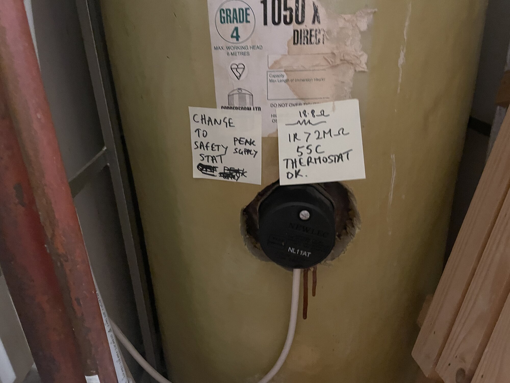

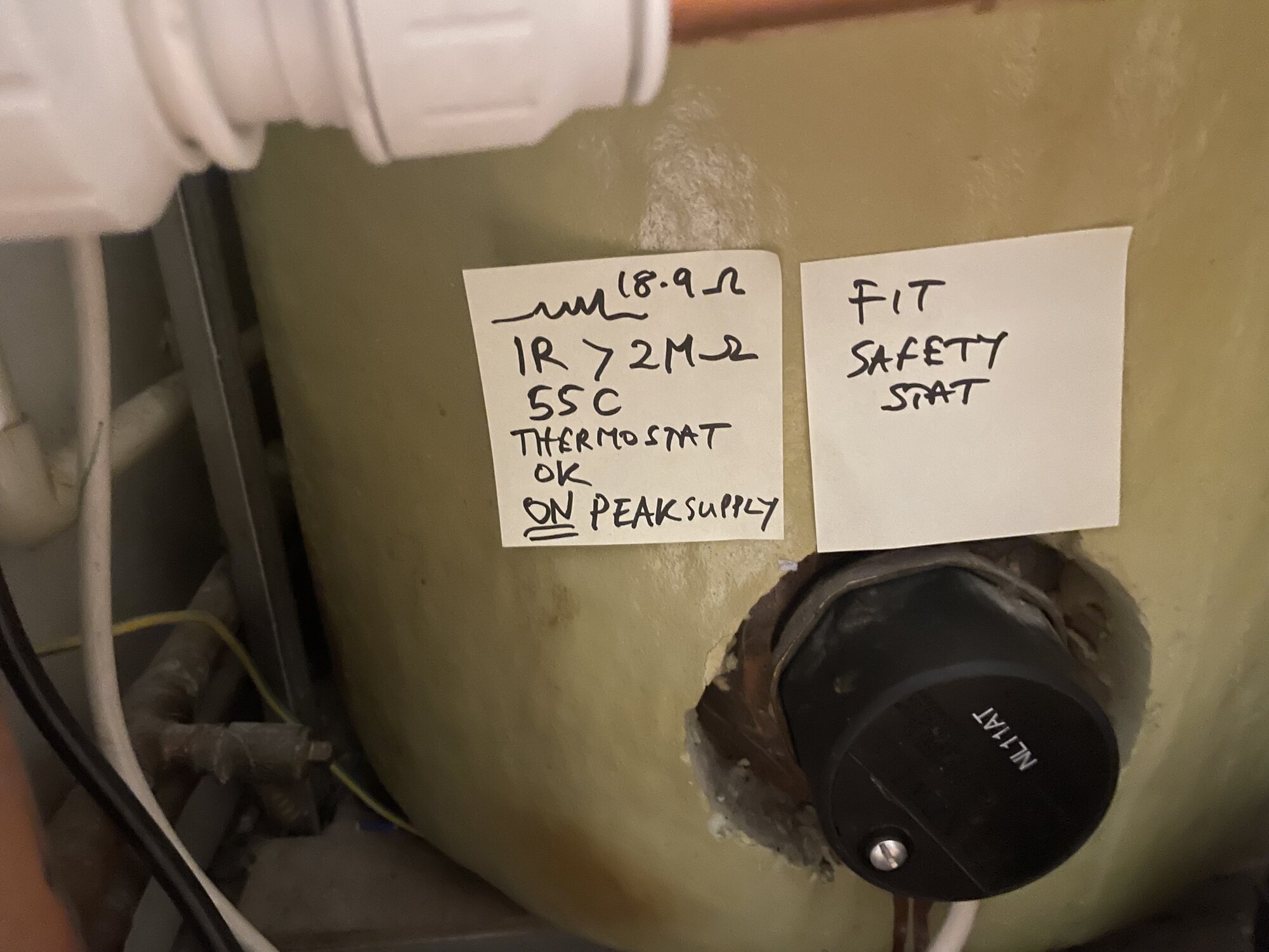

First Megan and her baby were very pleased with the generous help and advice from those who responded . I visited today and took a few photos and found out a few things:
1. There is a time switched off peak supply controlled by the meter and connected to the far right off peak main switch of the CU. I saw this supply turn on during my visit. The first picture below shows the peak and off peak supplies to two FCUs for the one and only storage heater.
2. Both immersion elements are sound as are their thermostats. However neither thermostat is a safety 'stat. Both were set to 55C. I have recommended the rod 'stats are changed to safety stats. The elements are both 11 inch. Each elements draws 13A. The switches for the elements are wrongly labelled. The top one labelled off peak feeds the upper elements and the lower one labelled on peak feeds the lower element. But see a later comment at 5 below.
3. The 24 hour supply for the storage heater is fed from the flat FRC. The off peak supply is from the first rcbo (B20A) to the right of the off peak main switch.
4. All the wall dimplex heaters are fed from the flat FRC and thus from the peak supply side of the board.
5. The two immersion heater switches are connected to the same peak supply B20A mcb - the one above which you see my ampclamp. I confirmed this by turning both 'stats to maximum and my amp clamp measured 26A and mcb buzzed.
6. The 13A socket for the water pressure pump is spurred off the immersion heater switch above it - you can see the wago connections behind the switch above the socket. Whereas the flat us wired in old colours the paralleling of the immersion heater switches and socket is done in new colours. The supply to all three from the board is the original old colours.
7. The second right B20A rcbo on the off peak supply says it is a for heater on the outside of the board bit is marked up with 'Imm' inside. I don't have a picture for that. There is an old colour cable connected to it but I could not establish where its goes. I suspect it is terminated in connectors behind the lower immersion heater switch or the 13 shower pump socket but I could not see if this was the case. I did not look behind the surface mounted 13 A socket - all a bit too awkward for me to do. Disconnecting this cable run, it measures open circuit between L-N.
8. I did not check how the lounge storage heater programmer was set up.
In brief then the only Eon controlled off peak heater is the storage heater in the lounge. Whether water heating uses off peak is by chance because Megan did not know that the whole flat (ie all the peak side loads) uses the lower tariff when it switches. (She has E10 which I checked on her bill). A phone call to be made to determine the off peak time slots but I have passed what I think they maybe and how to detect when off peak is available - the lounge right FCU neon light. The shower is fine albeit the flow rate is low which means that on the highest power setting the water temperature is too hot to bear. On the low power setting the water temperature is fine for a bloke but perhaps not hot enough for a damsel ;-). On the cold setting the water is cold and there is only a cold water supply to the shower.
The major work it seems to me is to provide peak and off peak supplies to the two IH elements, swap the stats to safety ones and provide a dedicated FRC supply perhaps for the shower pump 13A socket - or fit an fcu spurred peak IH switch.

So it’s wired --- over t!t, then?
Sort of. The tank elements only have one shared feed using one 2.5mm2 cable off a B20A on the peak busbar. I have advised Megan only to use one element at a time. Something has happened in the past to make this so and to change the pattern/brands of the IH iso switches.
