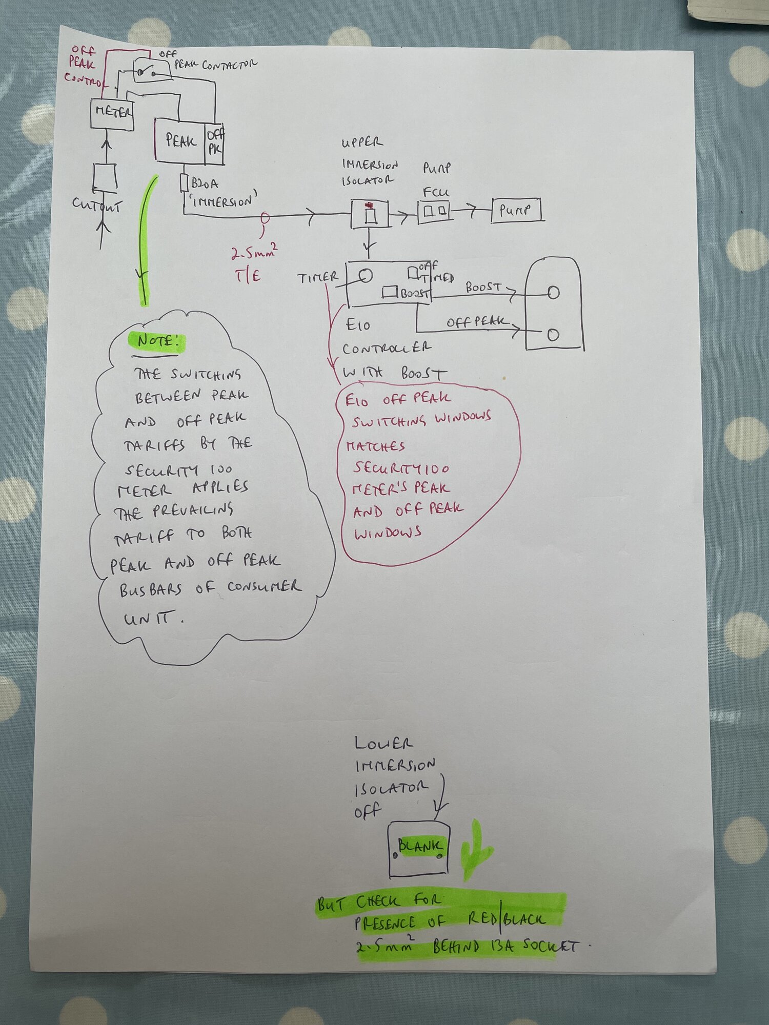

Hi
Absolutely 0 knowledge of this so excuse language / terms / explanation.
Electric only ground floor 2 bed flat ( 3 external walls)
On peak and off peak switches for immersion (water in a tank…goes to kitchen sink , shower , toilet and bathroom sink) - to note - this water is boiling hot - have turned thermostat down multiple times, think we’re on around 30c now????
If I turn ‘ON peak’ switch off & leave just ‘OFF peak’ on we end up without any hot water to sinks and electric shower.
On and off peak switches for storage heater. If I turn ‘ON peak’ switch off, this turns the power off to the storage heater (this is wrong, am I right?) which inevitably then leaves the ‘OFF peak’ switch irrelevant and it’s not doing anything.
Please please please can someone help me with this. I have absolutely no knowledge, I have had 4 electricians round my house and none of them can solve this issue (is it for plumber or electrician or combined???)
My bill is absolutely sky rocketing (not just due to increases as it was this way when I moved into the property 2 years ago and I have tried multiple times to solve) to put this into context I am being billed approx. £350 a month for a 2 bed ground floor flat…. This has been before the price increases also, since 2020 when we moved here and again I should add during winter months so problem kid mainly with storage heaters I believe but also immersion on peak off peak is wrong I believe.
EON refusing to help - say not their fault?
Paying ‘call out’ charges to electricians who cannot help…
My house is becoming covered in mould as I cannot keep up with the bill to heat my home and ventilate it correctly (too cold now with winter and a waste of the heat)
Thanks
So it's looking likely that the conclusions that timhoward and I came to at exactly the same time, in posts 31 and 32, that there was a fault with the off peak supply to the lower immersion are correct? This was then bodged to get the lower immersion working again, most likely without telling the customer that the cost of water heating would be doubled.
Yeah -we did ok!
But I can't get my head around someone's decision making process. I'd have thought the choices (most preferable first would be)
1) Actually fix it and sort out the off peak supply
2) leave lower IH connected to peak supply and fit a ?radio time switch. Customer has control over when there is hot water and can heat it up overnight.
3) leave lower IH connected to off-peak supply - Tank heats overnight at cheap rate, customer has hot water at better price for some of the day
4) leave peak connected to both IH's. Overload the circuit 24/7 and pay through the nose for perpetual heating of water.
Only a right muppet, or someone completely ignorant about how it worked would choose option 4.
The single feed to the immersions could perhaps be used as is by installing a Horstmann Economy 7 type controller, fed from one of the existing FCU's, which could output to the two immersions, as it ensures only one can be powered at any one time. So setting the timeclock to E10 periods would power the bottom immersion on cheap rate, and the rest of the time the boost button would be available for a top-up, on peak rate of course.
But would the pump draw too much to be left on that citcuit as well?
Your idea should be option 1a in my list. Nice!

I left Megan saying I would consult the contributors to her post and seek their recommended solution. She’d like it done during one visit by a recommended electrician - baldelectrician’s ex apprentice perhaps?
With the new expenses of a new baby to look after something economical yet allows best employment of E10 tariff please. Near M25 junction 26.

That is exactly what I have in mind, and the cheapest complete solution. No experience of the Sangamo, but from the link it seems to do exactly what the Horstmann does. Don't know why it's described as an 'upgrade' to the Horstmann?
Don't forget that the 'stats need changing as well.
The issue of safety overheat devices in immersion heater thermostats is becoming less and less important, as more properties and new builds use direct mains feeds to the hot water cylinders, or even utilise one of those horrible combi boilers.
The safety issue only really arises if there is a loft mounted plastic feed tank. Something which DOES very likely apply to this property.

Yes plastic tanks are there above hot water tank. We will fit safety 'stats.
Fellow electricians - an update.
First a big thank you to baldelectrician for the excellent recommendation. Mr K ON was spot on and Megan has kept his contact details should she require any further electrical work. You trained him well in theory, craft and safety and importantly how to comport himself in a stranger's home. He was quick on the uptake of my on-site brief.
The electric water heating is now under off peak control with manual boost and wired as in my #55. Over the next few days we just need to confirm the timings for the three on/off periods of E10 to ensure the Sangamo off peak timer is in sync - there are four E10 programmes which can be viewed at the link below second page bottom right.. I will pop back to adjust if needs be. See:
https://cdn.shopify.com/s/files/1/1...xi_User_Instructions.pdf?14510365057969918178
There was indeed a 2.5mm2 T/E feed in red/black to the bottom IH isolator. It was simply cut back and tucked out of the way. There was no continuity between this point and the 2.5mm2 T/E in red black wired into the far right rcbo (marked inside IMM) of the CU on the off peak busbars. All nicely isolated both ends now in wagos.
