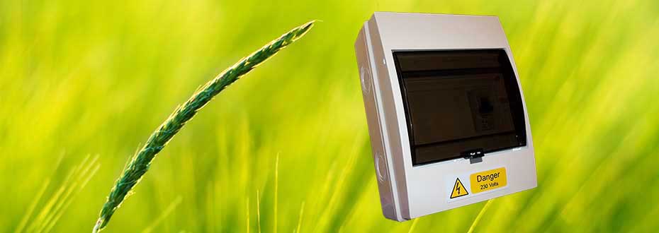

I have been using Anthony Woodridge's Sola Controlla for the past month and give it full marks. It appears to divert all available energy produced by my 3.3Kw PV not been used by the house to my 3Kw 27" immersion heater. I turned the immersion heater thermostat to max and now have scalding hot water on sunny days (rare at the moment) and acceptable temperatures on even the dullest days.
I just installed the Mark II intelligent version of solar immersion switch from Intelligent Solar Immersion Switch - Use Surplus Solar PV Power to Heat Water and really happy with the performance. It comes with a differential controller that monitors both PV production and house hold consumption. very affordable price too
Had a chat with the customer support and said they were working on a Mark III with proportional controller as well - don't know if it's true

Yes the Immersun modulates the supply to the immersion heater based on detecting the exported excess and feeding appropriately to the immersion heater.
