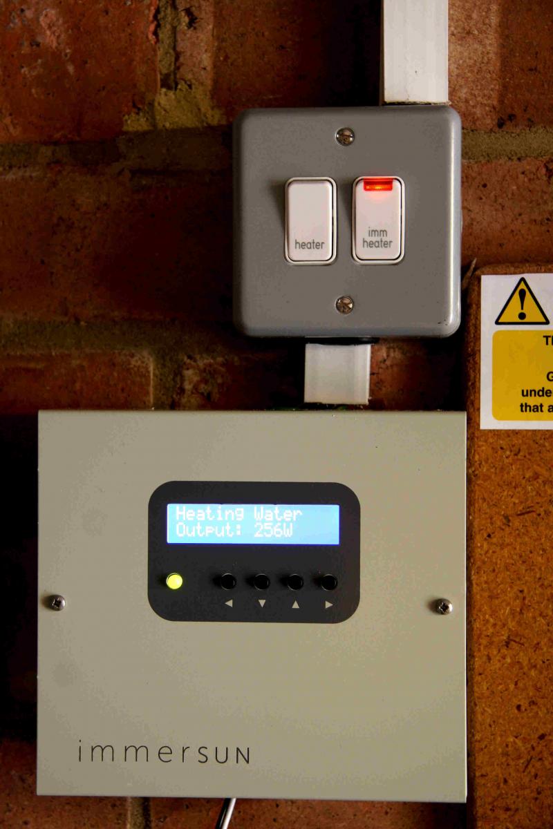

I may be able to give you a suppliers contact with or without an install package.It is very easy to install.I have attached a photo of the one I'm trailing at the moment.
Not necessarily - download the installation manual from their website - can be used for anything that is 'resistive' - immersion/storage heaters/towel rails etc.

You can wire it to both immersions if you have two. It has output 'load sensing' and a 'changeover relay' with several different software selectable options on how the relay is used. So with 2 immersions, you wire the top one as the primary via the relays NC contacts and the lower immersion as the secondary via the relay's NO contacts. The immersun then (proportionally) feeds to the top immersion until such time the top of the tank gets to temperature and the thermostat in the top immersion goes open circuit. The immersun then detects there's no longer a load on the primary output, so it switches the relay and now applies proportional output to the secondary (lower immersion). It periodically checks the primary load and will restart supplying it when it comes back in circuit.
