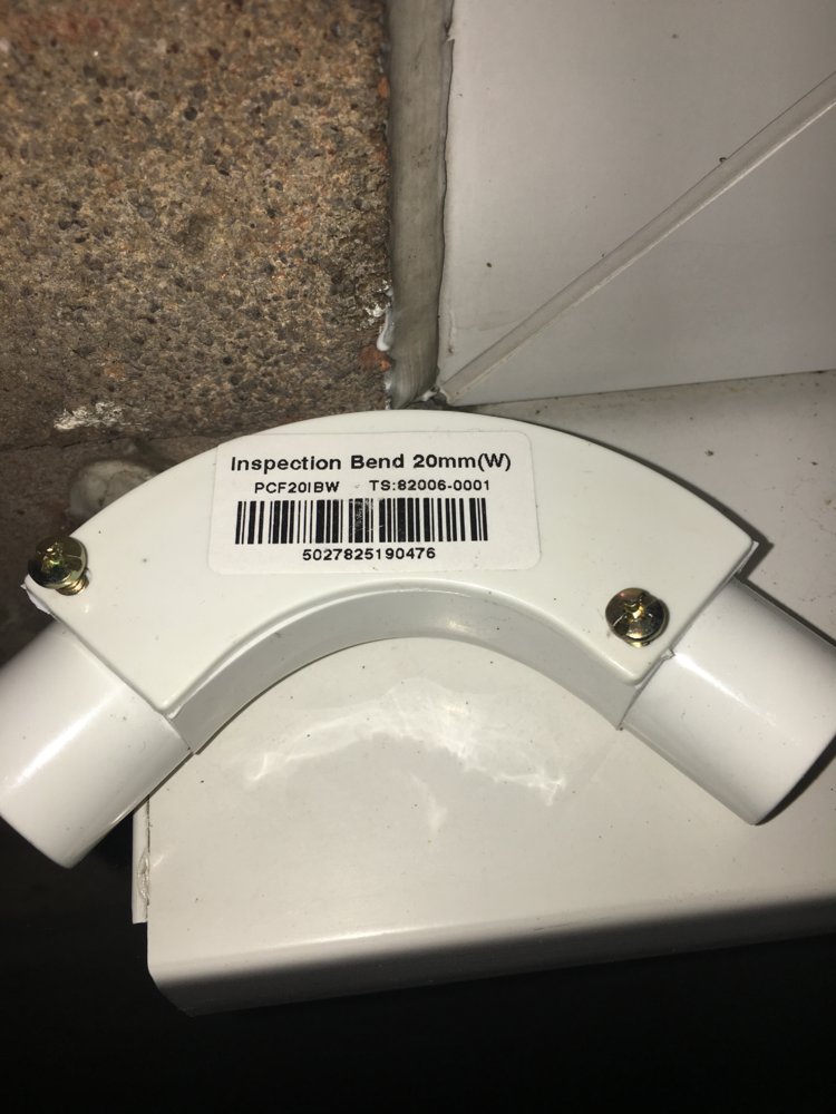

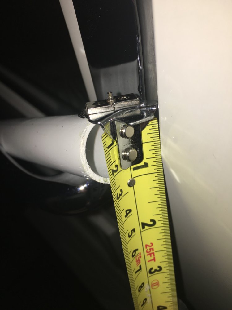

I’m looking to buy some PVC Conduit for some security lights rather than clip the cable. We don’t use it in work. But I know I need 20mm conduit but would I be okay using 20mm inspection elbows? I assume they just fit inside?
Measures the conduit and the inspection bend both 2cm.

Yes overflow pipe, but if you must use it, asa it is thick walled I have successfully turned it down at the end by putting a mandrel inside and turning it on an electric drill with some sandpaper or file, gets you out of a problem if needs be.

easier to get the right conduit. and why white? bloody eyrsore. black is more appropriate.
Every brand of conduit I've used has had the make and size printed along it - typically about once a meter. I try and put the printing at the back where it's not visible when I fit it.

As much as the hate a plumber on here extends, they have their own problems in that each manufacturer of plumbing fittings make then all a slightly different size so not that easy to co-ordinate fittings to fit together, and then we have tried to fit plumbing pipe into conduit fittings, will this madness ever end. LOL
Because I have white pvc windows and doors and a white iron gate. So black would stick out.
If it is being used externally it should be black.
That won't make it compliant as an electrical conduit though, it is manufactured to a different BS and made from a different material.
