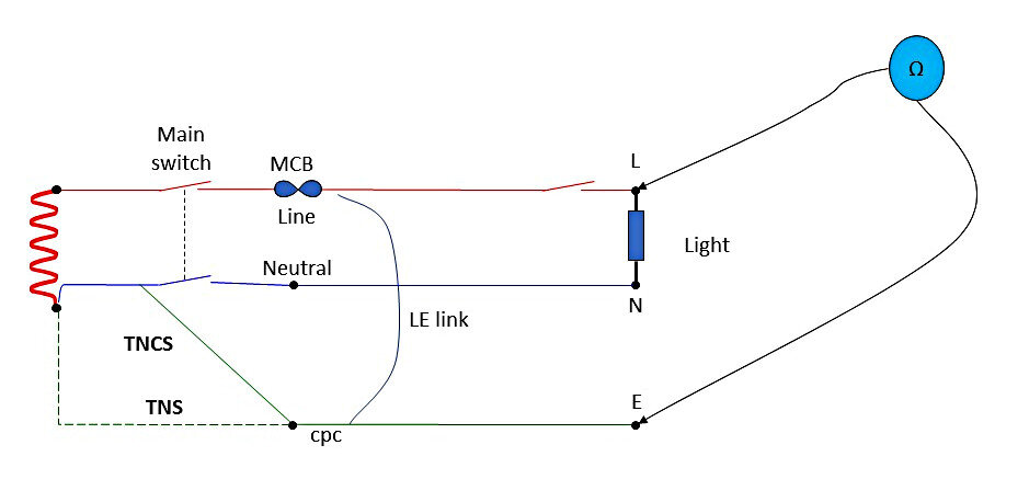

Hi. Testing an old lighting circuit today after a c/u change. First few readings were all fine. Then on one rose I got a reading of 0.5 ohms switch closed (fine) and 186 ohms switch open.
Is this indicative of an insulation problem or something else? I did an IR test and got 0.75 ohms but it was a bit rushed and couldn't be sure it wasn't just an error. That is very low surely? I'll do that again tomorrow.
I'd be grateful for suggestions!

I was taking a R1+R2 reading with the cpc still on the met and all mcbs open . I know this is wrong and can give multiple paths. Just a mistake. This was giving me a continuity reading (albeit a high one) when the light switch was open. I can't quite get my head around this. Was the high R1+R2 measured actually the path back through the sub-station??? Is that what you were saying Richard?
If Neutral and earth are connected in the CU bars and the main switch is closed then when the light switch is open the meter could measure a resistance loop, via the supply neutral earth connection, through the load and this could give a high reading of the sort of level you have measured.

You can see from this diagram that if you were measuring continuity with the circuit fully connected but only the MCB open then the reading with the light switch closed would give a resistance close to the R1+R2 you are trying to measure, if you open the light switch then the only path left is through the load back to neutral and if the main switch is closed then the path can go via the neutral earth link back to the tester.
The high resistance of this path will only lower the R1+R2 resistance reading slightly when measured with the light switch closed (resistors in parallel).

Thanks so much for posting this. Very helpful. The bit I couldn't get my head around is the main switch was open in my case. This would negate this path back?
I think I've tracked it down. It seemed to be a suspect pendant (it did have a small crack in it). In any case when I bypassed the pendant the rogue reading went away.
In the case of the main switch being open then this would probably indicate a neutral earth fault on the circuit (or a switch which was not turning off effectively). The appearance of a resistance reading in the say 20 to 900 ohm range tends to indicate measurement through a resistive load, by whatever means. Though this is a broad generalisation.
