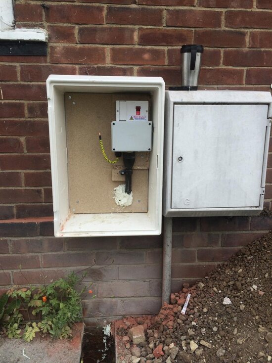

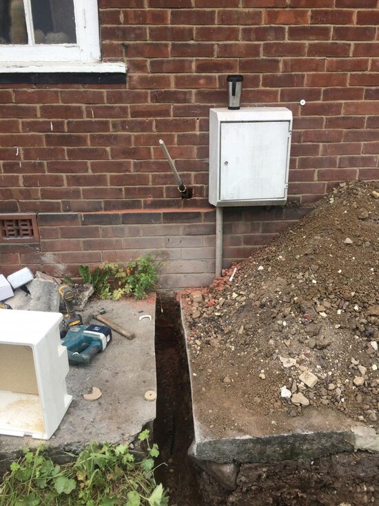

As Dillb said drill down at an angle to get you under the floor . On this job i stitch drilled out a 3rd of a brick on a downward angle . If the existing gas meter had been in a recessed box i would have followed suit .
View attachment 30528View attachment 30529
Waw have you really installed another meter box next to dno box! If you have that is shocking imo. Put ur switch fuse in the dno box, if its on. The owners property its theirs not dno so you may add your sw fuse in there! Flobbogasted at that pic!!
Looks like a gas box not electric.
There is a G written on it.
