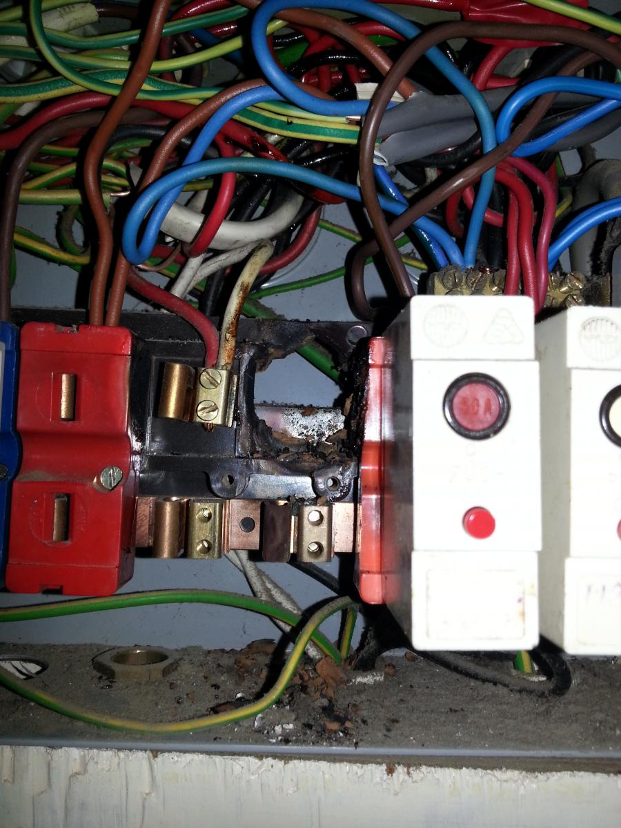

Had a call from a local cafe " our power keeps tripping and we have to keep resetting it but now the button is in but there is still no power" here is what I found
Food warmer, hotplate, kettle, toaster, fryer, Large coffee machine and a fridge all fed of the one 30A circuit wonder how it lasted as long as it has now has a new board and split in to 3 new rings and all the old melted chock block joints removed
Looks like a quote for a db and split up wiring circuits to balance load

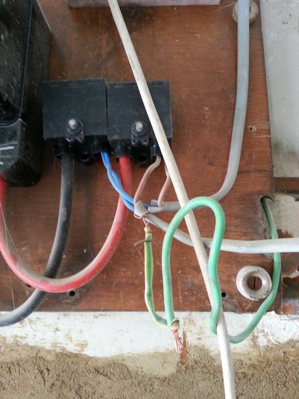

Builders way of wiring safely after removing old consumer which by the way was functional.
