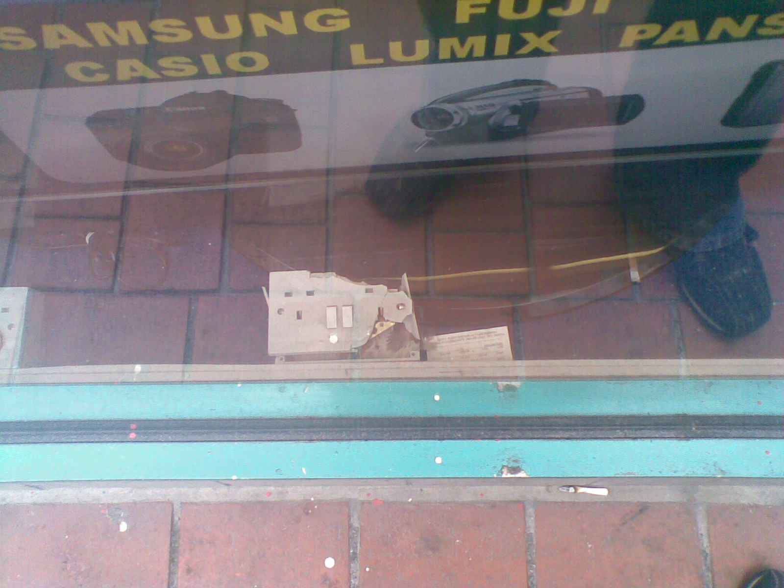

socket in the picture is live and in the middle of leeds city centre manager wont have it replaced and yes it is accessible to customers

Now that is beyond belief !!! That one has got me angry !! How much legal damage can we do to this shop ? Surely this shop is not safe for the public and should be closed till sorted- The health and safety exec have the powers to do this.
Re: Tell us about your faults !
I have passed on the information to the hse regarding shop address etc not holding my breath though
