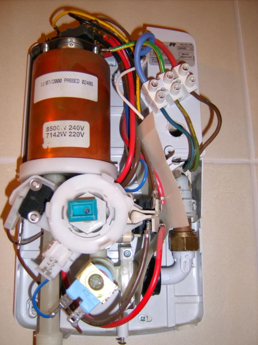

Well found a good one today ,asked to do a CDU upgrade and the house holder said about his shower and pointed to an old MK 20 amp switch ,yep 8.7kw shower installed just befor xmas ,tapped off the ring main in 2.5mm twe ,the 1.5 3 core flex from the switch to the shower ,now rewired with a nice bit of 10 mm , house was full of faults trapped earths neutral faults open circuit fault list was a mile long now all sorted

Went to house the other day to replace faulty 45 amp pull switch for shower. It had big brown hole on the front. After screwing it down found bad neutral connection had fried and burnt through switch. Its 8.5kw shower with 6mm fed from proper mcb and 30mA trip. So had to go into roofspace to get length on cable where i was amazed to find the lights wired in 1.5 through numerous JB`s with all earths cut off! Then discovered that either the lights were feeding sockets or sockets feeding lights! Found 30amp JB with 2 2.5mm cables and 3 1.5mm cables. 1 for shaver liight/socket. 1 for upstairs sockets and then for lights. the 1.5 for the sockets was then split by couple more junction boxes to more sockets some with no earth and all in 1.5mm cable. Spent two days rewiring through the upstairs. It was Bungalow with upstairs conversion and found that downstairs was well done and everything labelled and tidy but i very much doubt it was spark who wired upstairs. The Family that are living in house bought it as it was and only for the fault in shower we discovered the rest. Surly they have some comeback on the seller of the house on this.
