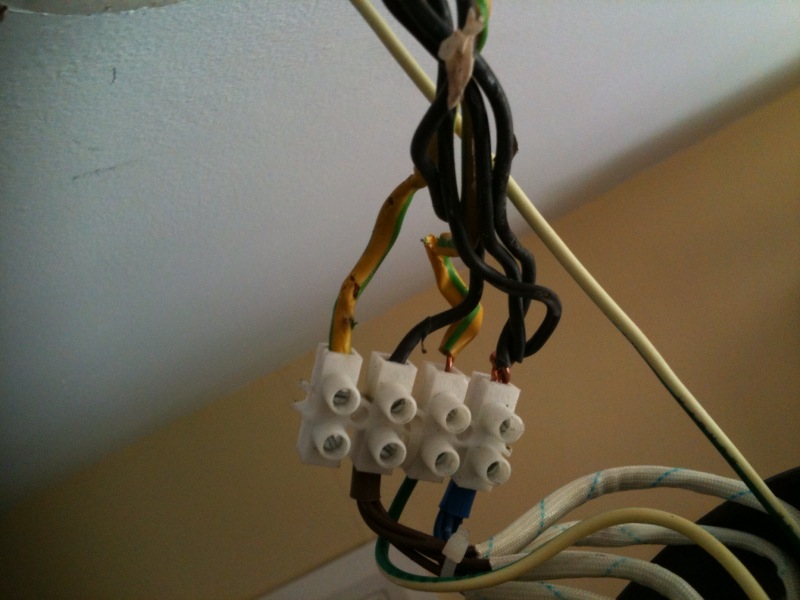

Then there's this one what could be the outcome of these pics. There is a lose neutral at light fitting which you can't tell form the Pic but what else?

Then there's this one what could be the out come of these pics. There is loose neutral at light fitting which you can't tell form the Pic but what else?
They've missed an earth when putting on the tyewrap?:p

Looks to me like the fitting had been sitting at around 230v :D
The switch plate was also running at 230v, the earth for the switch line was terminated with the light fittings cpc fly lead, nice there was a nicked neutral touching the outer casing of the light. You can see it in the last picture of the blocks 2 earths at the end and the lone one in the center:eek:
