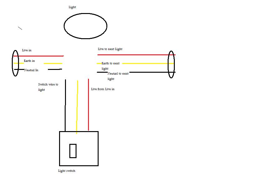

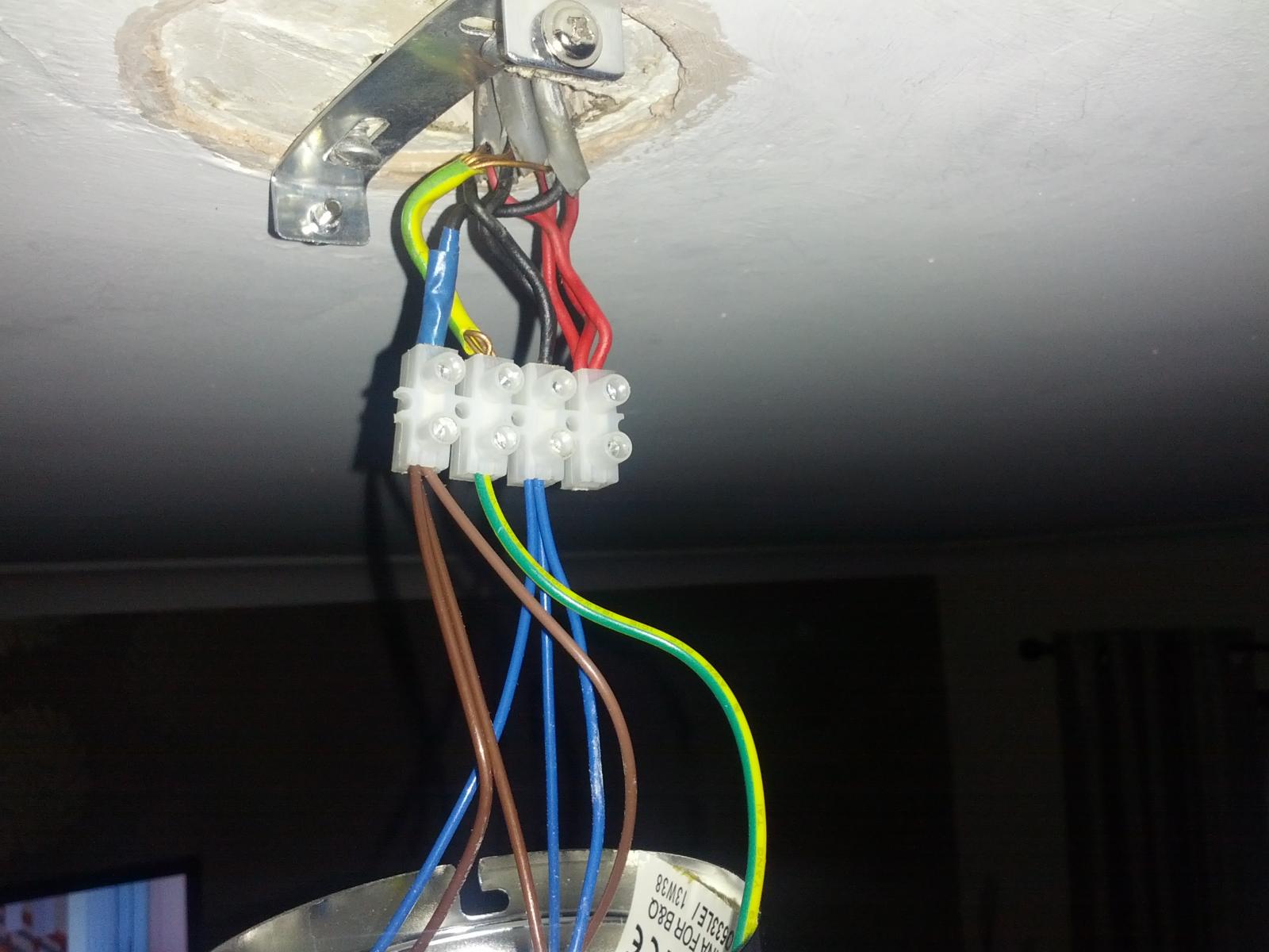

Has me in a state of confusion...
We live in an early 80's house so the wires coming from the ceiling are 3 red, 3 black (one with blue tape, assuming they ran out of red) and 1 earth. Our new ceiling light has 3 blue, 3 brown and 1 earth.
I have tried a multitude of combinations and have failed to get the light to work at the same time as the switch i.e if the light does come on the switch does nothing. Other attempts have stopped other lights downstairs working correctly.
Could you possible advise how you would deal with this situation? I feel like i have tried nearly every combination.
Thanks in advance

I wish i had taken note of how it was wired previously hindsight is a wonderful thing
next time get your phone out mate and take pictures, takes 1 minute and saves all the ball ache
A more experience member will help but red is now brown and black is now blue
I know behind the socket you would have 3 brown on a 2 way, 1 common and L1 and L2(strappers)
for 1 light you would have the usual Neutral, Line and CPC, did 3 lights used to come on when using the switch?? because if its only 1 light then surely it would be just 3 wires in total
Trying to get him more mixed up, eh?
The new ceiling light has 3 blue and 3 brown and 1 earth with a blue and brown terminating in 3 bulbs.
There are two switches in our living room which used to operate the old light independently.
So I will place:
the reds together not connected to the light.
black with blue tape into the brown from the light.
black with no tape into the blue.
Correct?
