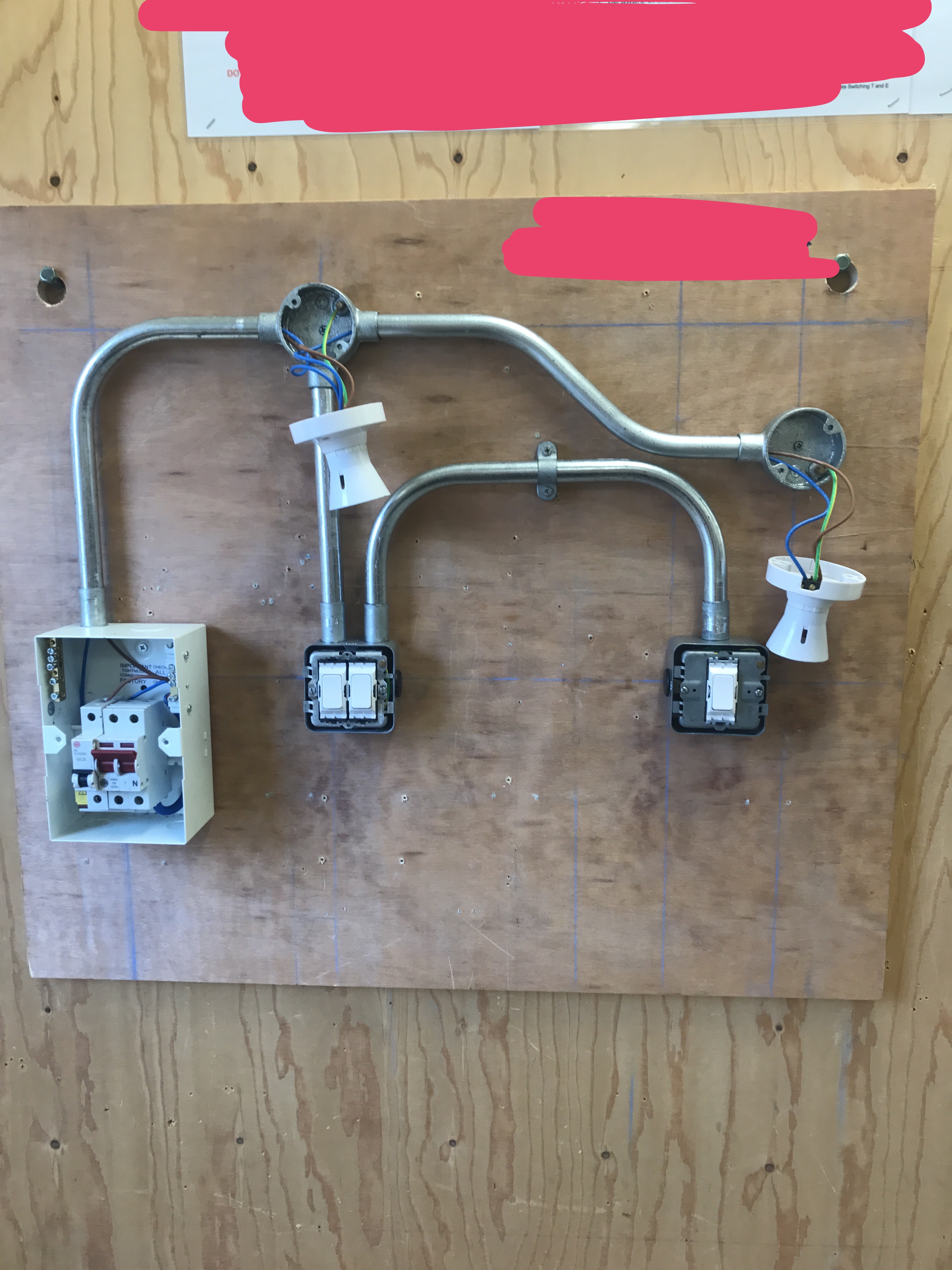

Thought I'd get involved and post some of the stuff I have been doing at college. Nothing on the level of everything else I'm seeing on here but to be fair I am only on the level 1 course!
Currently doing 1 & 2 way lighting. Tried to make it as neat as possible.

That is not bad for a first attempt, no signs of creasing on the conduit and everything reaches to the accessories. (how much did you have to throw away!)
I have slightly changed the perspective on the picture to assess the true better and it seems straighter.
As you get the hang of the overbend and spring back it becomes easier.
