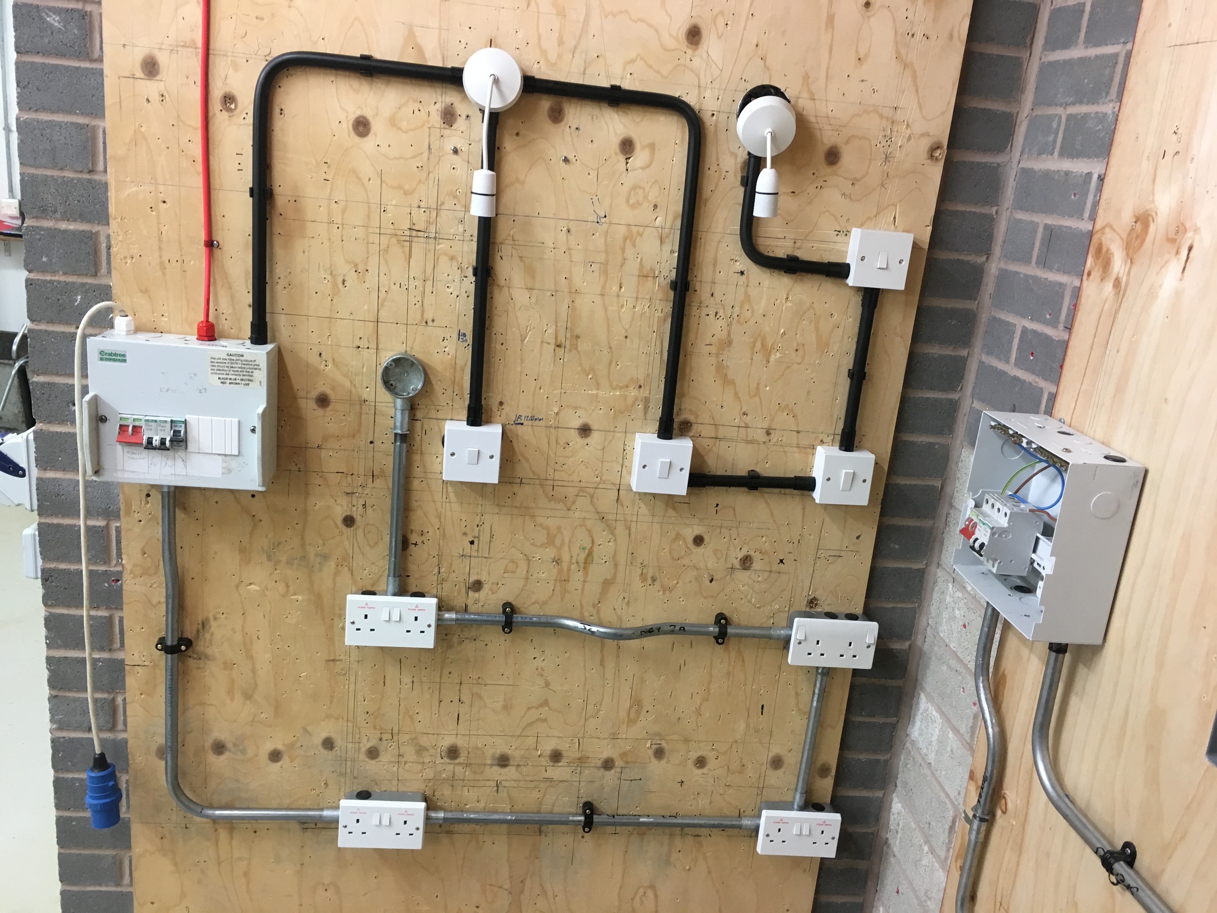

Level 2 College Project
Everything except the emergency stop button
View attachment 41475 Level 2 College Project
only 2 things on there that i absolutely hate are cable ties not cut flush, and cable ties round the lip of the tray. you can buy precision flush cutters for a few quid. otherwise, a nice neat install. tese are what i use.
Xuron 170-II Micro-Shear Flush Cutter - Heamar Company Limited - https://www.heamar.co.uk/cutters/43926-xuron-170-11-micro-shear-flush-cutter-615265902053.html?gmc=3&gclid=CjwKCAjw4sLVBRAlEiwASblR-_KEqWJQosNVsEQEVq99JbrKlx5ax-OKNAw8aVjHwV8vgs7ANV-HDRoCst0QAvD_BwE
None of the cable ties are around the lip, it's not the best picture but they are all on the base of the tray itself.
Do these comments mean it's a nice safe installation, well thought out and maybe just a couple of quibbles about personal preferences?
If so, then it's a pretty nice job, methinks...
