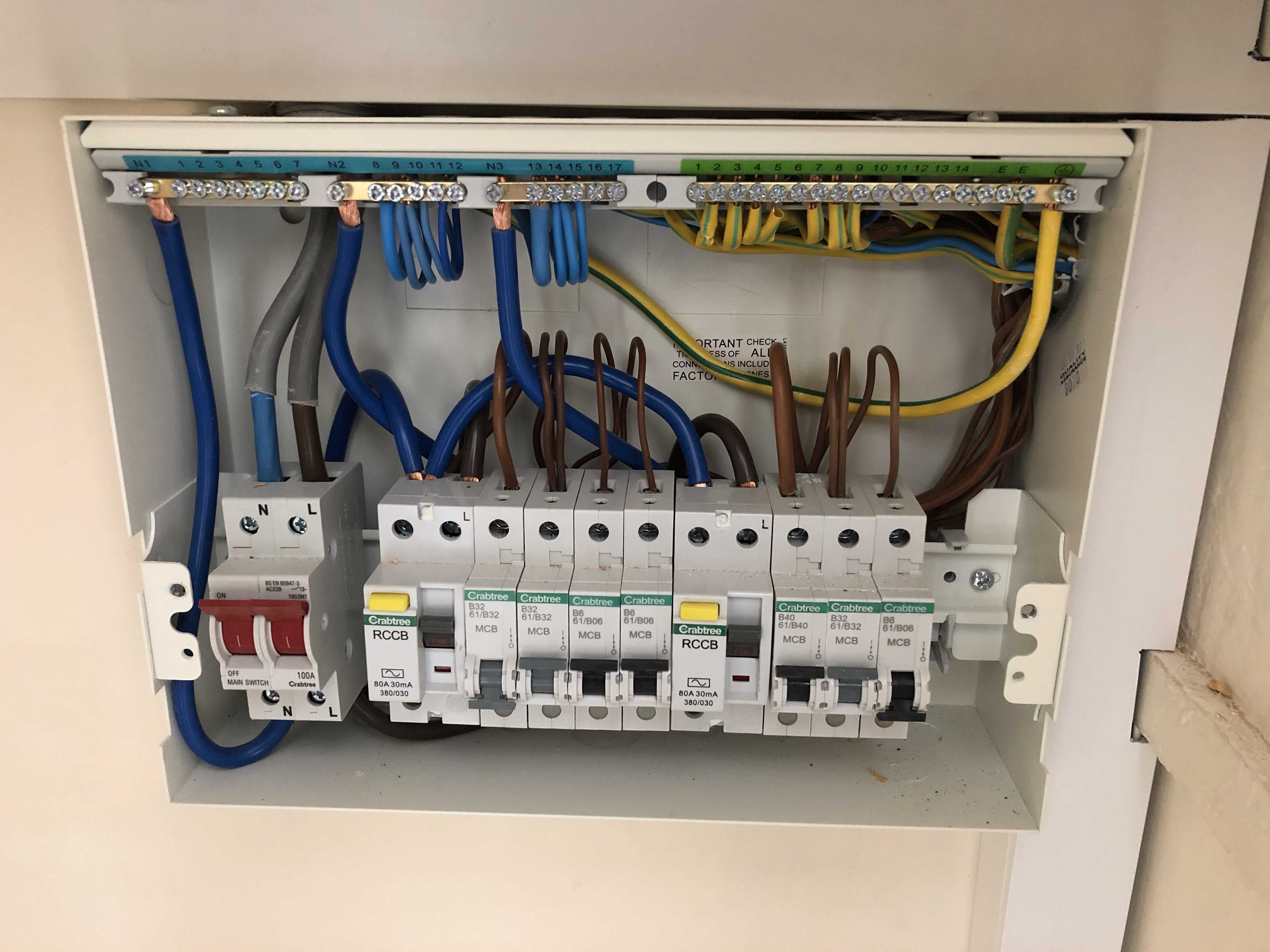

currently a sparkys mate, starting my apprenticeship in June but first go at board connections.. not the neatest as could have done with an unmounted board to make it neater from the start :oops:

Not too bad there, a bit busy in the board and some exposed copper on the left hand line connections.
The incoming supply cable for the installation looks horrible and I am interested that SP do not isolate the neutral, no need to do so but why not if you can.
Keep at it and it will all become second nature!
