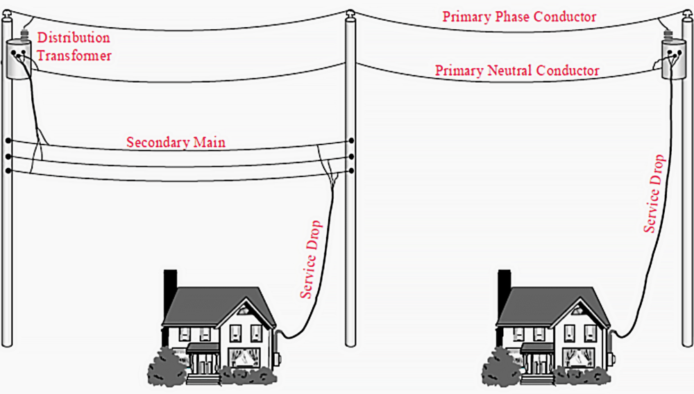

A bit late but if curious here is how US homes are served outside major metropolitan areas:
1-7 homes on a single transformer. Primary neutral ties in with the secondary neutral. Any phone or CATV is also tied to the secondary neutral at the pole and again at the home.
