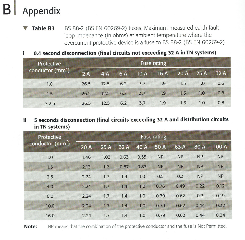

In reality few electricians have to use the adiabatic equation (though they should know how to) as the IET's On Site Guide has some useful tables that incorporate the information for circuit design. For example this table is for BS88 fuses and shows the maximum Zs values for different CPC sizes:
For example, if you have 10mm T&E cable with a 4mm CPC used as a sub-main feed so you could allow 5s disconnection, you might have a 63A fuse for short circuit protection only, and then the downstream DB can use a mix of MCBs up to 32A in order to provide overload protection with a reasonable chance of selectivity. Looking at the above table you see you max measured Zs is 0.49 ohms, so your final test at the nice new DB would be to confirm this is met.
Also you see the value is 0.62 ohms in all the larger CPC sizes - they are time-limited for the fuse action, where as at 4mm it is adiabatically limited (hence lower Zs for a shorter fault disconnection time).
