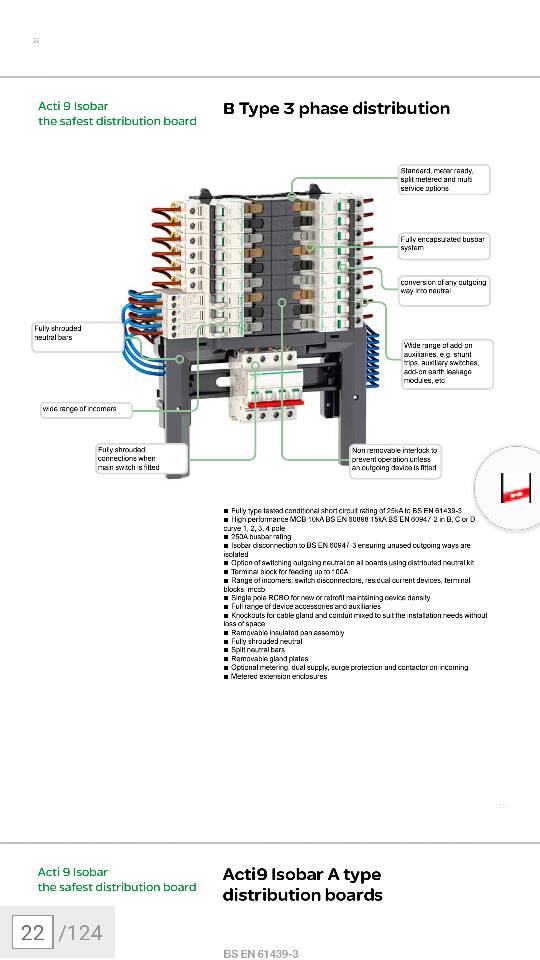

the acti9 ones will comply i recon with a metal door
the mc wylex boards look alright ive not fitted on yet though (10 way split load)
this is the first pic i found

Acti9? Why do these Schneider CU's have so many different names.
The only two I have seen advertised are the Easy9 and Resi9 although the Resi9 seems like gold dust
That Wylex one looks OK, which CU would you need for all rcbo's that can be mixed with mcb's? There are so many variations
acti 9 are the old merlin? i think
im quoting skeltons old post from a different thread
Easy9 is just rebranded Square D. Complete rubbish IMHO. Acti9 on the other hand, the rebranded Merlin isobar gear, absolutely lovely stuff!

I would take a consumer unit to be a final board feeding circuits feeding current using equipment. I would take a distribution board as a main board feeding maybe several sub-boards or consumer units. Daz
Acti9 are their distribution boards
Easy9 are their consumer units
a db is a consumer unit, just another name for them.
you get single and tpn 10 way+ consumer units under acti9
acti9 are merlin gerin
easy9 are square d
Or put another way, Acti9 is the series derived from the extremely popular and high quality Merlin Gerin Multi9 range, and Easy9 is some ---- derived from the old SquareD domae/qwikline garbage.
told ya dave
