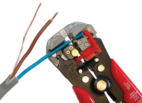

On another note does anyone know of THE quick way to strip 10mm?, something i only learnt a couple of years ago
One of these works a treat!
