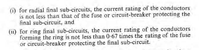

In brief, a ring final circut is an exception to the normal rule than the cable can carry at least as much current as the protective device.
The one and only reg (look up 433.1.204) sets out the conditions you can break the normal rule, and part of those conditions are a 30 or 32 amp device.
It's basically saying that if the load current is unlikely to exceed the CCC of the cable for long periods, and the cable can carry 20 amps, it is deemed to comply.
(Much older regs versions had more flexibility with formula to apply the same idea to a wider range of circuits, but those days are long gone)

Regulation 433.1.204 seems kind of dumb where it states the 30 / 32 amps on a rfc
I don't disagree. Bring back the 14th edition!
Being more specific that rule is an exception to the usual case where the protection against overload has to match the cable. In the RFC case you are allowed 50% over due to the two 'legs' of the ring largely sharing the current but they pin it down to this case.
The earlier regs allowed this 50% margin (or the cable CCC is 67% of OCPD) as a general rule, later it became an RFC is 30/32A but I suspect the real reason for changing it was to prevent "creative" designs of a 45A ring on 4mm cable, etc, being created.
