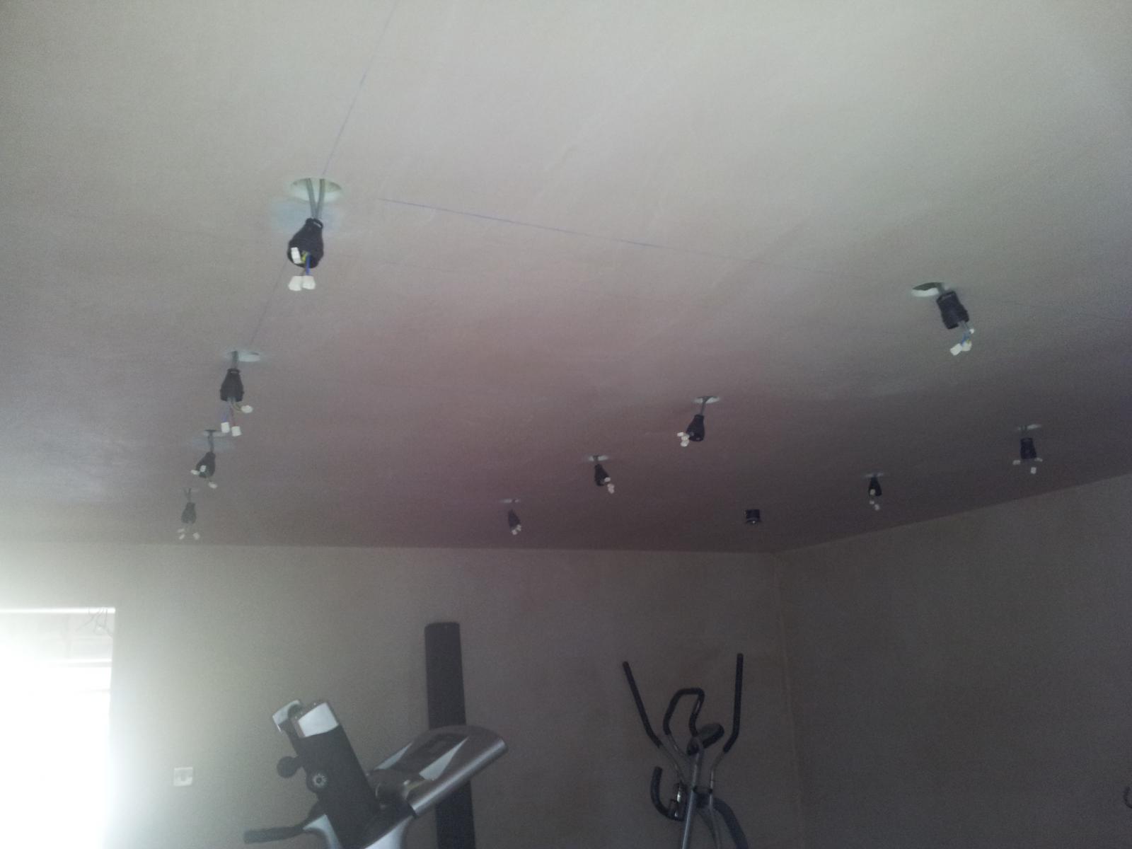

I have been asked to fit downlighters to a hallway and also a kitchen all on the ground floor.
The customer would prefer me not to take up the carpet and floor boards above, but I cant see anyway around this? I might be lucky with the hallway and have them all in a straight line running the same way as the joists and manage it with cable rods but the kitchen will have the lights all over the place.
Is there anyway of doing this without taking up the floorboards?

I'm actually feeling ok about it as 4 of the lights are in a straight line running the same way as the joists and I know where the joists are. The one problem is getting the feed to them, this is from the present hallway light which will need to go through one joist to get to them. Haven't looked to see what is above that light yet (would be great if just one cable, but highly unlikely, probably 4), but ok to put a wagobox up there.
Its just the 'getting to the joist' to drill through the centre that sounds tricky. I guess just bite the bullet make a hole big enough in the plasterboard to get there (its not lathe and plaster). Bit controversial but could I just notch the bottom of the joist and then put some metal capping to protect cables from future work? That doesn't sound great, would be good to get some views.

Heres what I, and all the sparkies I know personally would do....
Mark all yer holes, draw round the holesaw and check each one is clear with a spike and cut the holes. Where you have to jump joists, find the edge of a joist with a cable rod in the downlighter hole then chisel a rectangular slice out of the cieling about 3" by 1" under the joist, clip the cables to the bottom of the joist (metal capping is not gonna proitect a cable from anything) and chuck a bit of filler in on top of it. Peice of cake.

i've done a few like that, but you need to protect the cables. capping is useless, use the 3mm thick ones with spikes that are designed for this very purpose.
