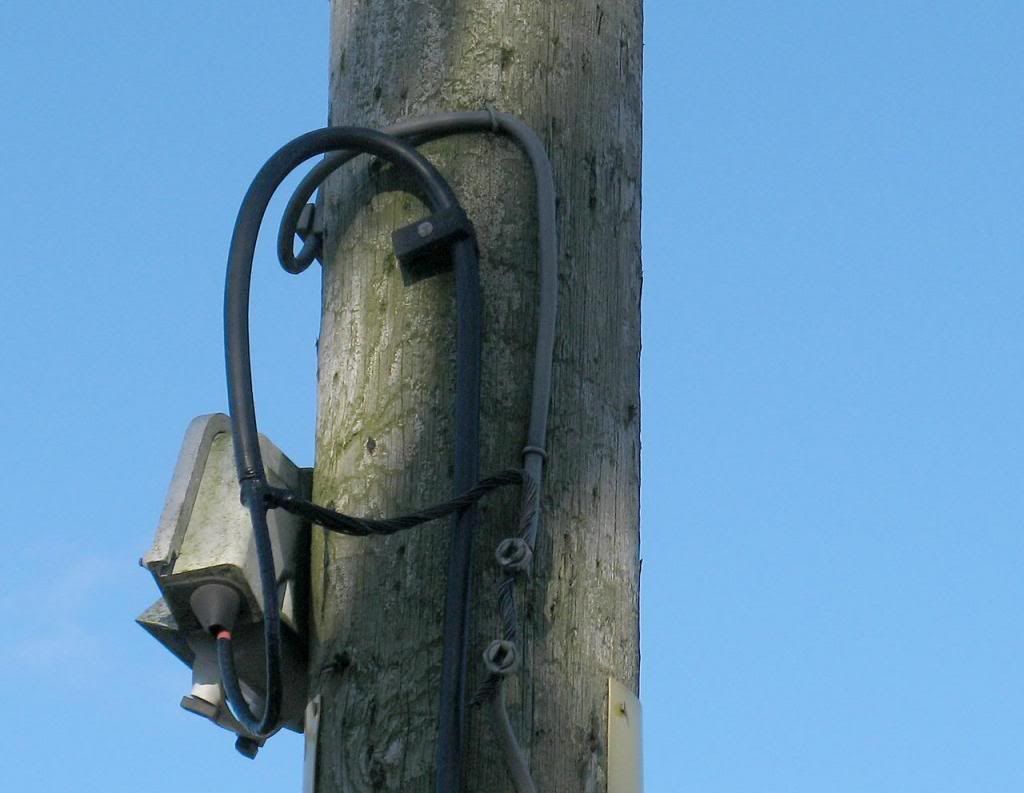

Here's our overhead supply for comparison and comment. Our transformer is served by two high voltage conductors, which in turn come from a string of poles carrying three conductors - ie two of the three branch off to our property. I assumed these were two phases from three phase, but comments here now make me unsure.
One green/yellow sheathed cable comes from the case of the transformer into the ground on the N side of the pole.
On the other side of the pole the two cables out of the transformer join the underground service cable which goes to our meter cabinet. One connects via the isolator or fuse or whatever it is (the grey item), the other is clamped directly. After the join to the service cable, there's another earth that goes underground at the foot of the pole on the S side. The DNO guy who traced and marked the cable routes for us said that this would run some distance horizontally underground while still insulated, then further distance uninsulated.
Our earthing arrangement was described as "CEW" and also "TN-S" by the DNO engineer, after he opened part of the cut-out to check.
