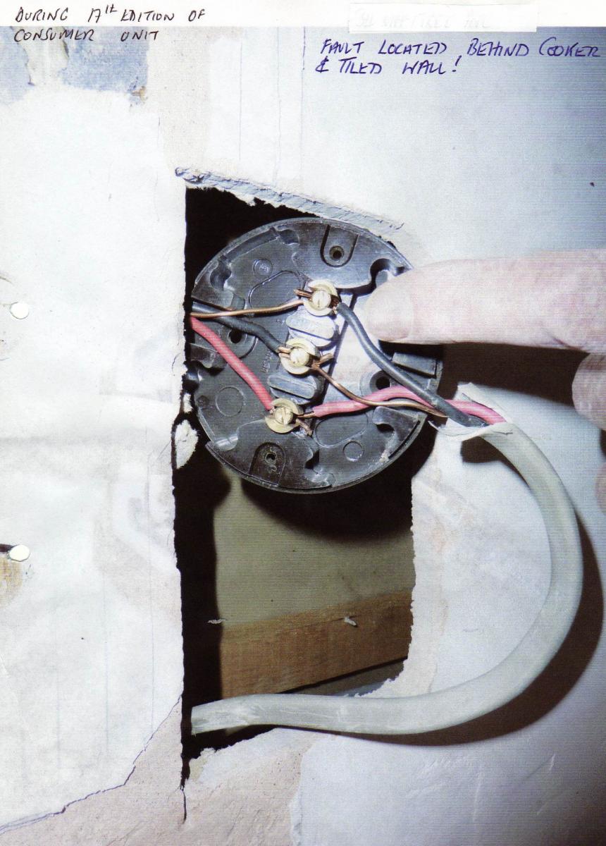

A quick 17th Edition CCU update I thought but the house ring circuit was showing a short between neutral and earth? This was caused by an incorrectely wired junction box behind a stud wall in the kitchen. To add to the problem, the kitchen walls were tiled - fortunately a retile was on the cards.
The complete update job took me 2days. Since I was doing it for family, I was not charging for my time - don't you just fall-in with these family favours!!!!
it hasn`t even been done rite anyway that joint box...and i aint on about the lack of G/Y sleeving to the CPC....but why does the CPC cross over the neutral like that?....that CPC should terminate into the middle termination of the three.....

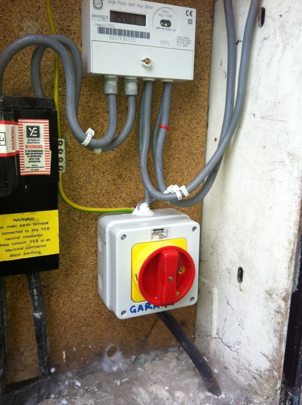

I visited a property last year with an older rotating wheel type meter. The meter glass had been broken and clothes peg clamped on the wheel to stop it going round.
Far safer than sticking wires up the cavities:):):)

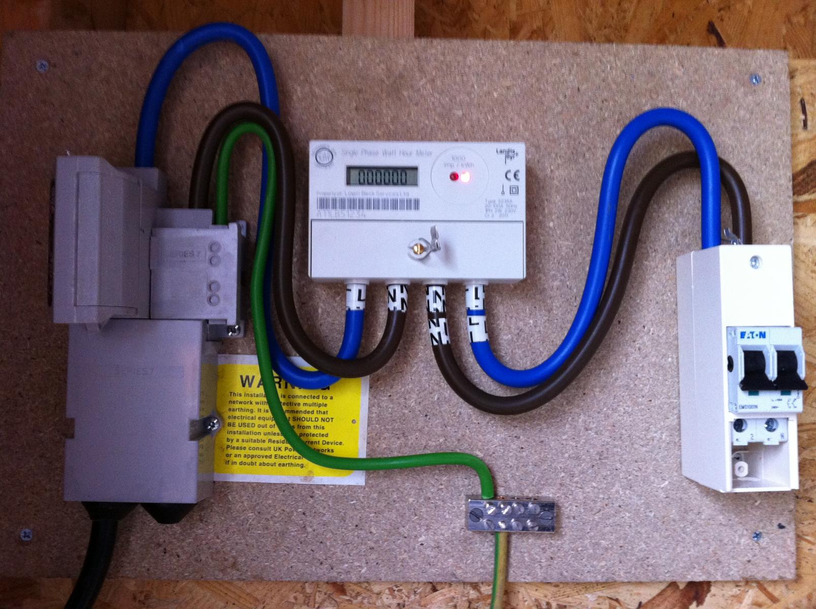

New build, private customer. Meter guy turned up on dec 23rd (friday) and did this! at least he labelled it up correctly.

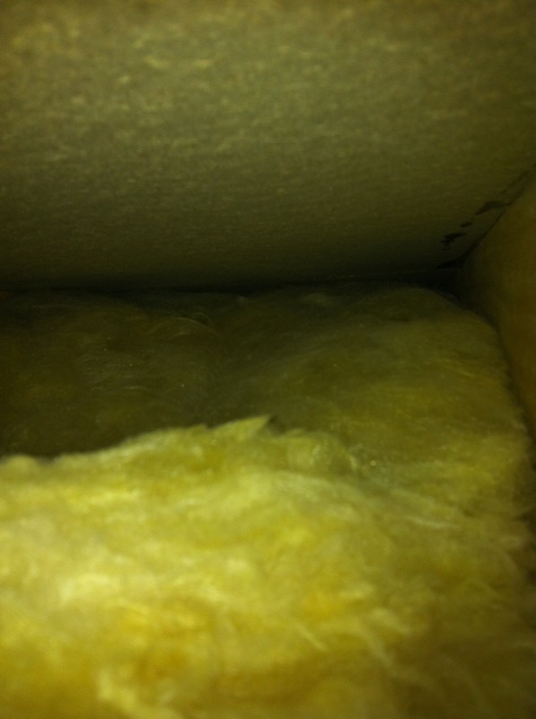

Replacing 2 noisy fans in a new build for customer.
Took the first one in downstairs cloak out to find that there is no ducting to it whatsoever!!
The van is blowing into a small void created by pushing the insulation back that is in floor void between ground and first floor.
Second one is upstairs en suite.
Here the ducting is actually there.
However the builders / spark couldn't be ar$ed to actually connect it up.
Fan was simply blowing into the loft.!
Classy.
