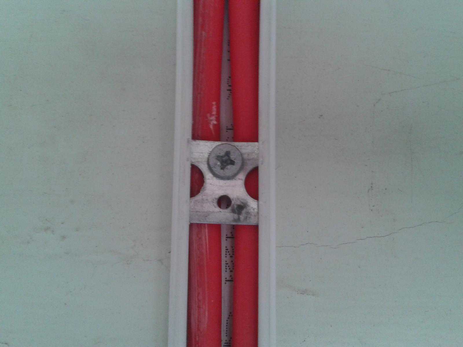

Back on topic these were advertised in the most recent professional-electrician magazine, IMO these look a little better than the other ones posted earlier.
Fire Clips - D-Line
Fire Clips
The D-Line F-Clip has been tested by Warrington Fire, confirming compliance to BS5839 part 1 - copy test report on request. The tests confirmed that the F-Clips, ...
Fire Clips - D-Line
Fire Clips
OMG!! They look brilliant. (Not mentioning the white trunking for a fire alarm though)...
