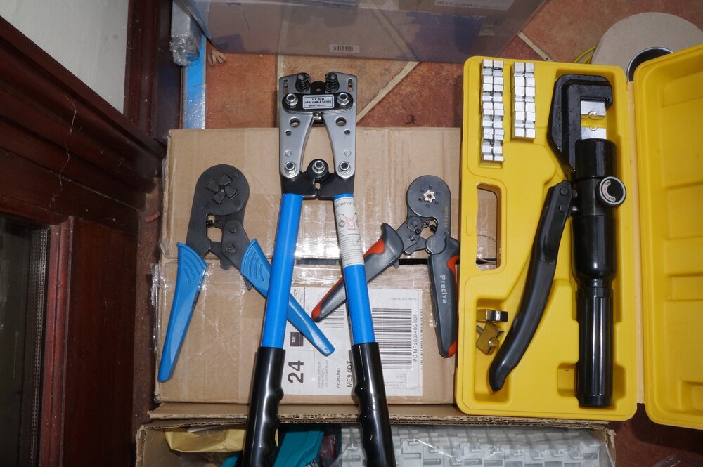

Now and again, I need to join a cable that is buried in a wall, sometimes in a stud wall, sometimes to be plastered over. Sometimes when someone has drilled through it (last one was a kitchen fitter who should have known better), or sometimes to extend a cable e.g. to move an accessory lower on the wall. Generally I'm thinking of 2.5mm2 or 1/1.5mm2 twin & earth. And assuming a new cable can't easily be pulled through.
What jointing method do people prefer?
I've used heatshrink crimp butt connectors plus an outer covering of glue-lined heatshrink. I worry about the crimp not gripping one of the conductors tightly enough and it coming loose.
I've also used heatshrink solder connectors, again with an outer glue-line h/s covering. If the copper is not clean enough, I worry about a dry joint to one of the conductors.
And what if one cable is new solid T&E, while the other cable is stranded imperial cable?

What size cables are you intending to crimp Mike?
The inline crimps I have for 2.5mm are impossible to squash with a hand crimper: 2.5mm² Blue Butt Connectors - https://www.tlc-direct.co.uk/Products/CTBUTTslashB.html the above unit makes short work of it.

In a scenario of cable being drilled into for example, as a last resort the cable can't be replaced, joint can't be left above wall unit etc (Wago), I've used butt connectors & heat shrink, as you've suggested. I bought some of these, but not used them yet;
They'll be some arguing against using crimp connectors on solid cables, but I've seen that disputed on another forum.
