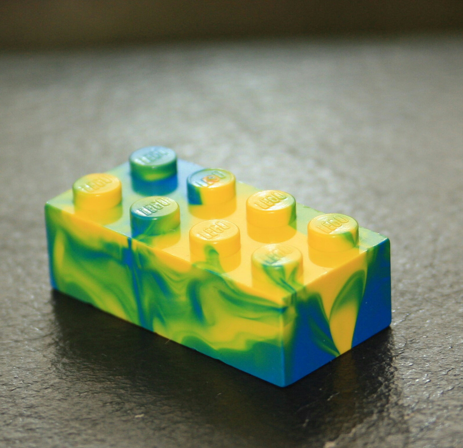

Is it not possible to make green/yellow plastic, they have opted for green which I suppose does indicate earth whilst those cheap nasty inline connectors we have seen on here opt for yellow which doesn't indicate earth. Seems like a good idea.
it can be done.
it requires a special screw in the injection moulding machine (known as a marbalizing screw)
this is the sort of thing you end up with
That's lime??
