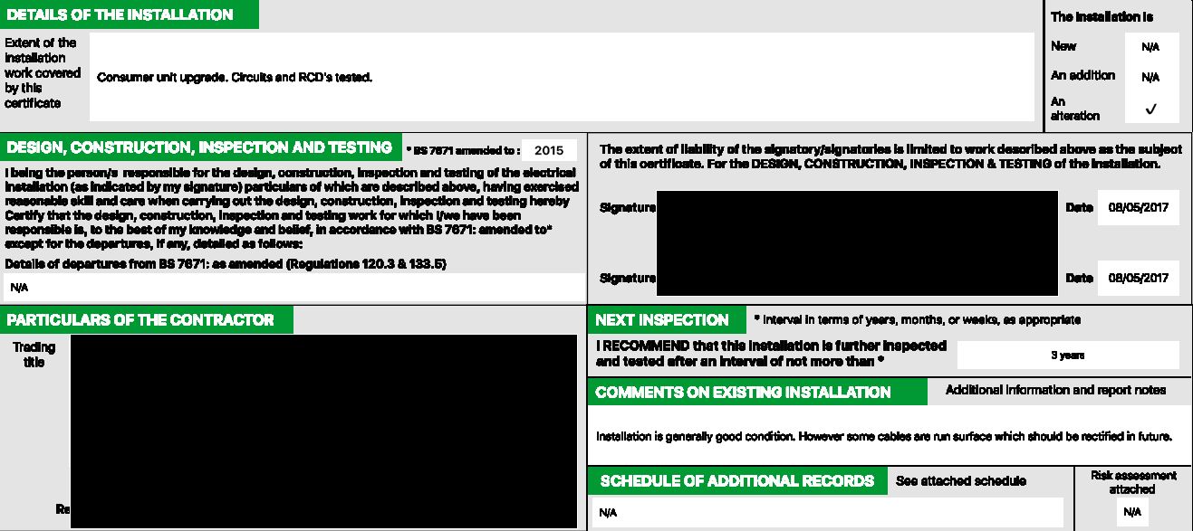

Some circuits are run surface and should be rectified in future ?

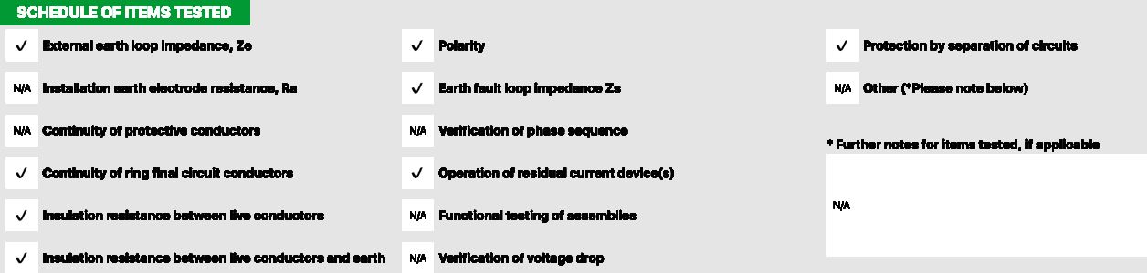

The consumer unit is a 11 way,the test schedule lists 5 ways,the 2 Rcds seem to have 3 circuits each ,decisions,decisions,try as I will,I just can't make sense of what has been produced
Is that right a measured ze of 0.65 ohms?
The zs results are less than the ze?
Wonder what the earthing system was.
Supposed he must have measured zs rather than the calculation as the zs readings would be higher with the calculation.
