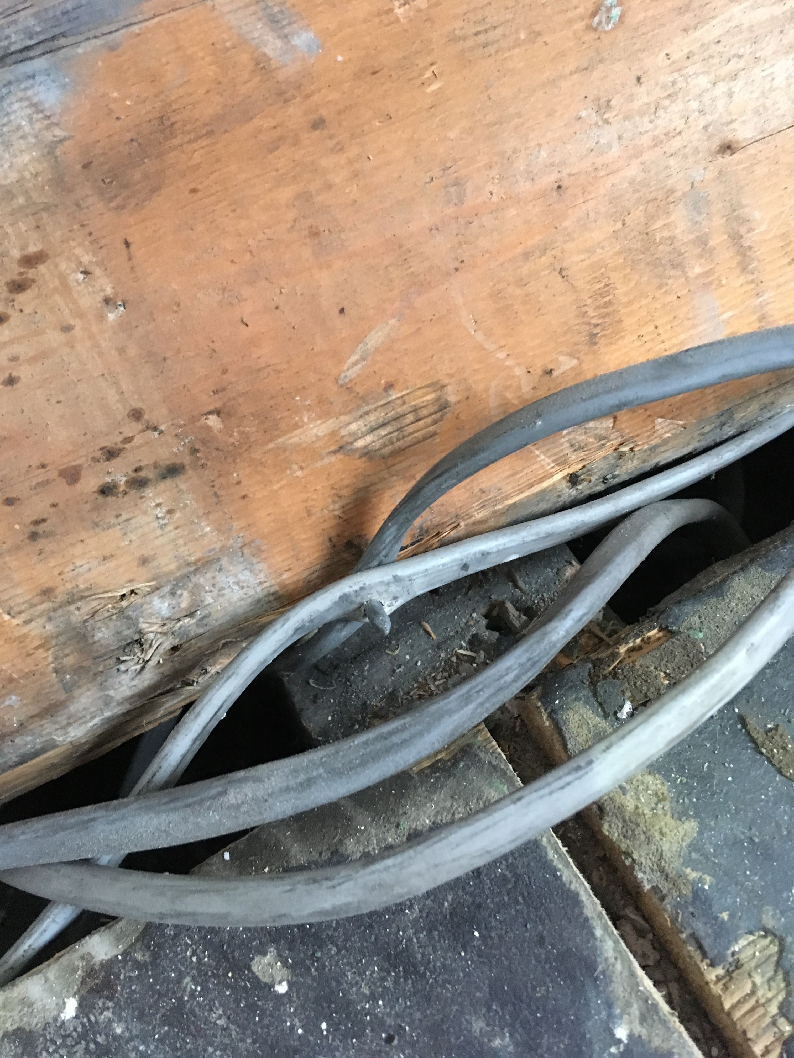

I have one due very soon - it’s taken me two days so far to test, fault find and rectify. Things like this NE fault on a lighting circuit as shown in image above (Light was still working!). Other faults as well.... a bit of a list.
I just want a full schedule of good test results before swapping out. Dangerous faults found were found and rectified before re-energising. I’ve still a couple of further investigations to carry out.

View attachment 47704 Interesting post this. I’ve only just started consumer unit change outs.
Then again my customer is very understanding. The vast majority of the wiring is in good condition. He is saving thousands by getting repairs instead of a rewire.
I can’t imagine swapping a CU and ‘hoping for the best’. (Comment not aimed at the OP - but if I’m honest - am taking his dilemma as reinforcement on my desire to thoroughly test first).

Being on site could you actually see how they managed to get that nail through that second cable , obviously it must have been trapped, but how have they hammered the nail in in the first place?
