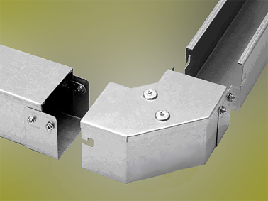

Fire resisting supports in escape routes
BS 7671:2011+A3:2015 (IET Wiring Regulations Seventeenth Edition), which was published in January 2015 and comes into effect on 1 July, will include a requirement that wiring systems in escape routes shall have fire-resisting supports. The requirement is included in a new regulation (Regulation 521.11.201), which is reproduced below.
521.11.201 Wiring systems in escape routes shall be supported such that they will not be liable to premature collapse in the event of fire. The requirements of Regulation 422.2.1 shall also apply, irrespective of the classification of the conditions for evacuation in an emergency.
NOTE 1: Non-metallic cable trunking or other non-metallic means of support can fail when subject to either direct flame or hot products of combustion. This may lead to wiring systems hanging across access or egress routes such that they hinder evacuation and fire fighting activities.
NOTE 2: This precludes the use of non-metallic cable clips, cable ties or trunking as the sole means of support. For example, where non-metallic trunking is used, a suitable fire-resistant means of support/retention must be provided to prevent cables falling out in the event of fire.
The termwiring system ’, which is used in the regulation, is defined in BS 7671 as ‘an assembly made up of cable or busbars and parts which secure and, if necessary, enclose the cable or busbars.’ Thus the term covers cables (and busbars) together with any containment system for them, such as conduit, trunking and cable tray.
Reason for the new regulation
The purpose of Regulation 512.11.201 is to improve the safety of firefighters and others in escape routes under fire conditions. Wiring systems that drop and hang across escape routes due to failure of a means of support in fire conditions have the potential to entangle persons. In recent years, a number of firefighters have died as a result of being entangled in this way.
Application of Regulation 422.2.1
A further requirement of Regulation 521.11.201 is that the requirements of Regulation 422.2.1 shall also apply, irrespective of the classification of the conditions for evacuation in an emergency. Regulation 422.2.1 contains various provisions for safety in the event of a wiring system being affected by fire.

For Amberleaf
Re: Regulation . 521.10.1.
The Note to Regulation 521.10.1 requires that, if a system includes site-fabricated joints, the installer must confirm the completed item meets at least the degree of protection IPXXD.
Just for a reference example:
The Answer to the regulation
BS7671: 2008 – Amendment No. 1: 2011 came into force for all new designs on January 1st, 2012 and Section 521.10.1 stipulates the need for trunking to deliver IPXXD or IP4X protection when used with single insulated (non-sheathed) cables – something that standard IP30 rated systems do not deliver.
IP4X distribution trunking is currently the only system that meets the IP4X requirements of the amendment to the 17th Edition Wiring Regulations. This has been achieved through the introduction of a cover strap, which is simply connected to each coupler over the joint between the two lids, and a new range of IP4X fittings that integrate fully with existing lengths and accessories to deliver a fully compliant solution.
As with the standard trunking, IP4X trunking has been designed with speed of installation in mind.
For IP4X protection, simply clip a ‘cover strap‘ to each coupler over the joint between two lids
IP4X fittings should be specified to achieve the correct level of conformity
Only be treated as an aide-mémoire to the Regulations and Electricians should always consult BS-7671:2015: to satisfy compliance.
