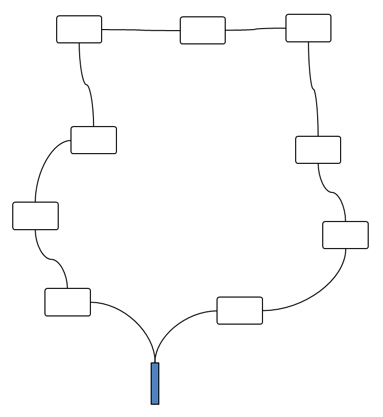

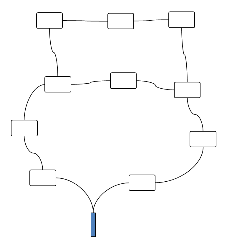

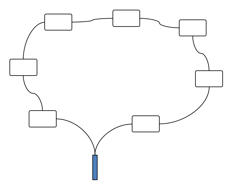

(A) has lots of potential for issues, (B) does not, and therefore (A) does not comply with the regs
As we seem to be in the mood to endlessly debate this now-fixed case, lets move on to the issues with the case of (A) and why it would not be acceptable.
As for the OP's initial discovery there is nothing intrinsically wrong with (A) that presents an operational safety hazard here (assuming all cables are rated OK for ring final use, blah, blah) but it would be a problem for testing or future work as it is so unconventional and unexpected.
So how would it be coded any why?
The answer is probably heading towards the answer for (B), save for the "how many cables can my MCB take?" question.
Discuss :)

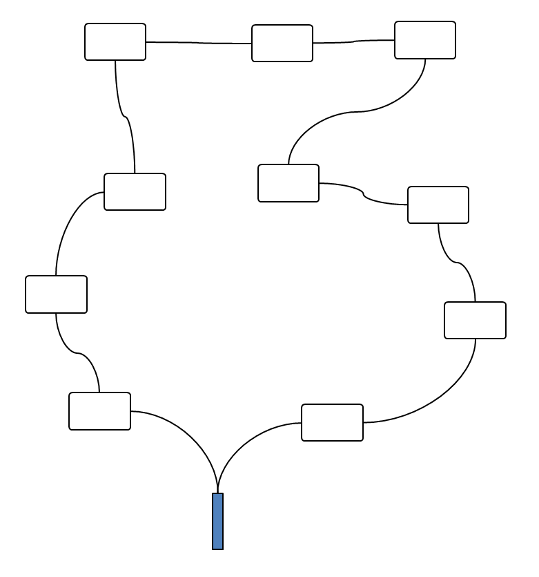

I would code situation (A) as a C2.
My reasoning...
(i) it's not a ring
(ii) it could be difficult (depending on cable lengths) to establish it exists
(iii) it could be difficult (depending on cable lengths) to establish there isn't a break in the interconnect
(iv) if we can't be certain it exists and we can't be certain it's continuous, we cannot be certain the cable won't be overloaded under normal use
(v) because we cannot be certain it's continuous it's feasible we may not test the entire circuit during IR testing
And that's the crux of it. It's mostly about our inability to properly test it and thus our inability to be certain it's safe.
