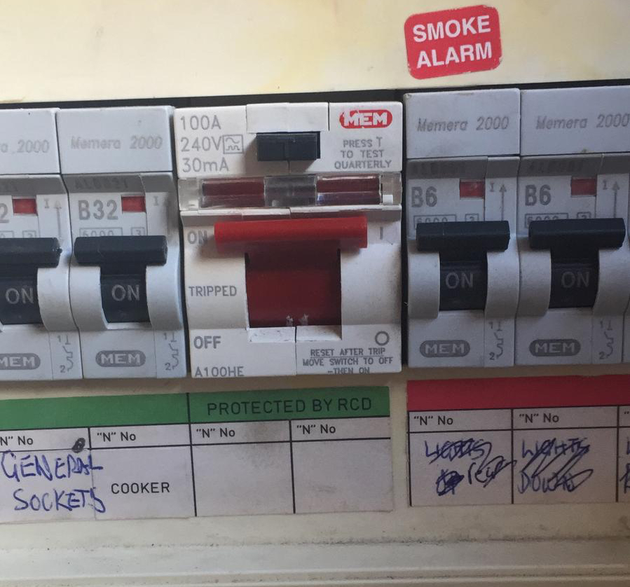

Pictures below CU open
Only RCD - red middle switch trip
Also, tenant tells me today, that when trip happens - Plug circuit all off, But Light circuit stay on (lights work).
Of course. It’s only the sockets (to the left of the RCD) that are protected by the RCD.
The circuits to the right of the RCD do not have RCD protection. Don’t know why the labelling has been crossed out.
