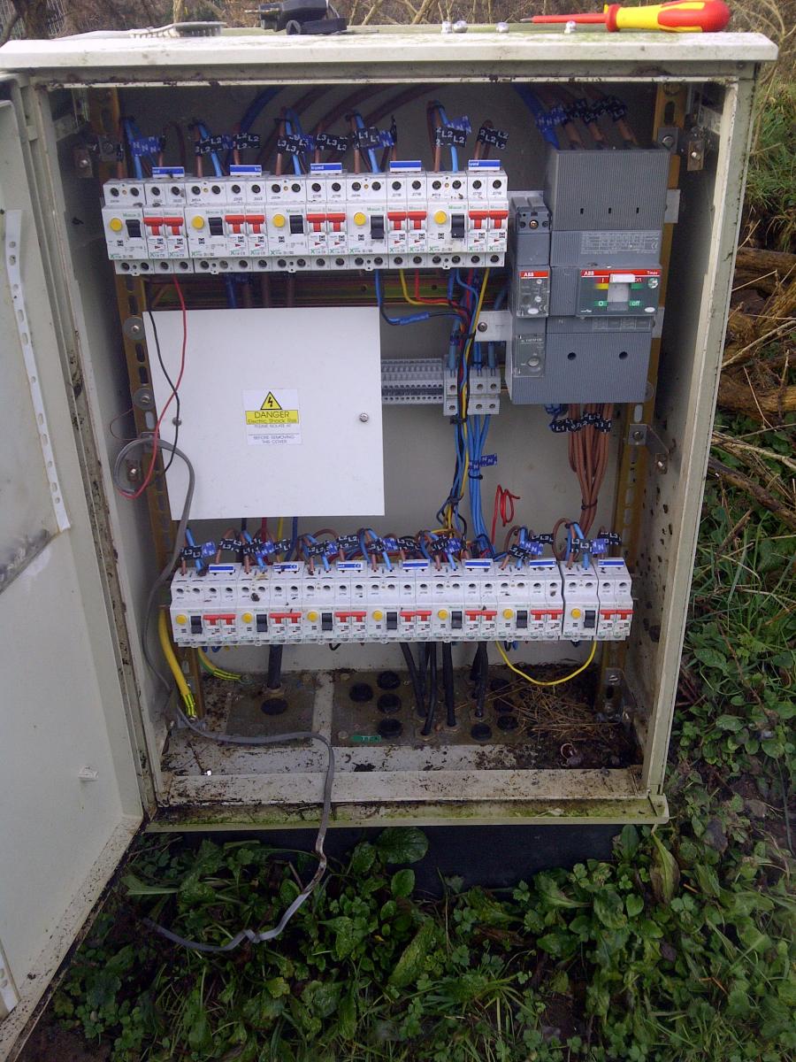

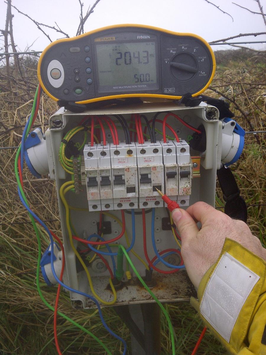

HI Guys

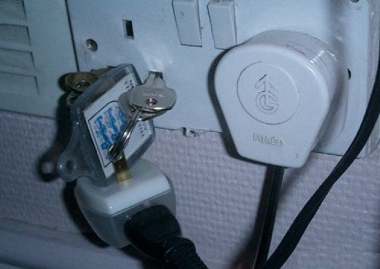

Just got back from holiday went with my parents and our aunty and uncle in two caravans to france. So we get to france arrive at the campsite. Plug the caravans in and then plug in the plug in checker to test for reverse polarity etc. It comes up with no earth. Go to the box open it up and press the test button on the RCD's and they trip. While I am doing this my uncle is connecting his gas but he couldnt get the gas to ignite so wondered across to look touched his regulator and got a belt. So we went to the reception and told them about it and they sent down the "electrician" He arrived on his scooter with a volt meter. Speaks a little english plug it in L - N and goes "look fine" We go that N the problem is earth so tell him to put it L - E which reads 110v. Again he says "look fine" we go no its meant to read 220 -230 ish. So he stands there and shrugs his shoulders and replies " so you want me to take the front off??" So he takes the front off the box and finds that the Earth wire isnt connected into the earth connector. So he attempts to connect it using his nice big bunch of keys.
