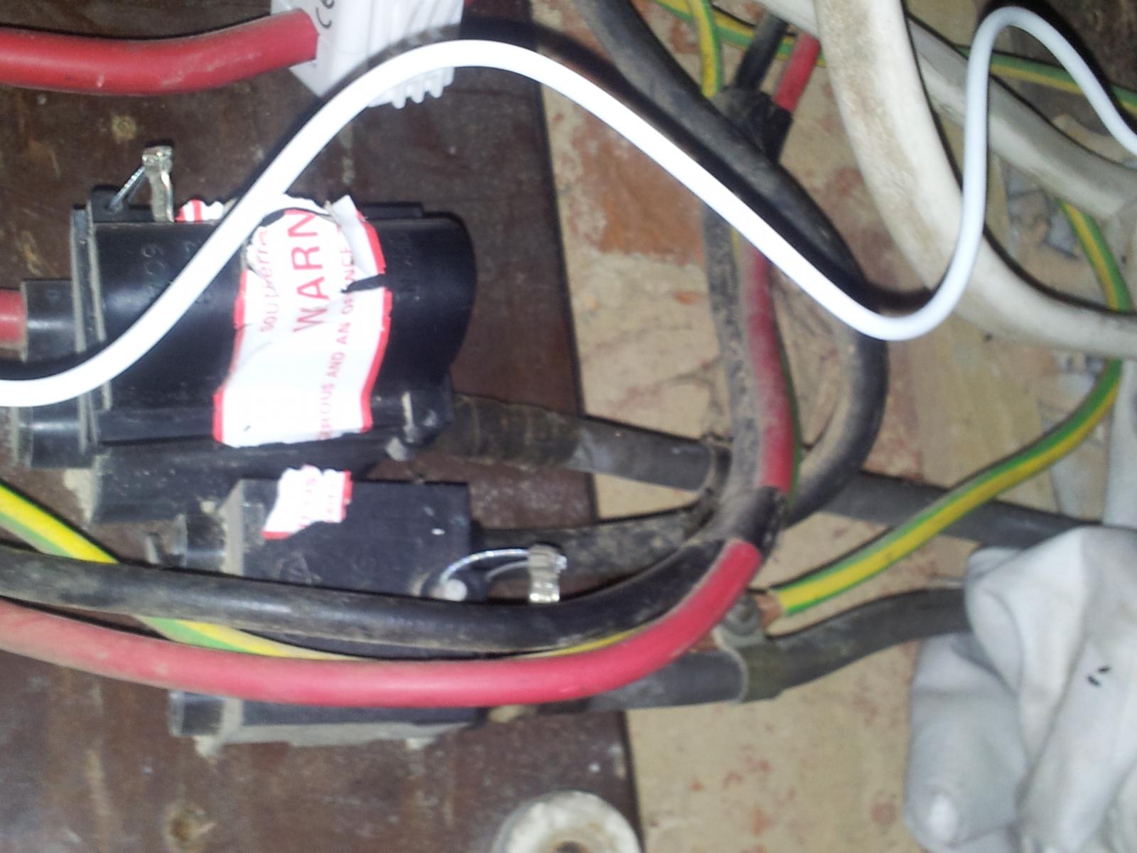

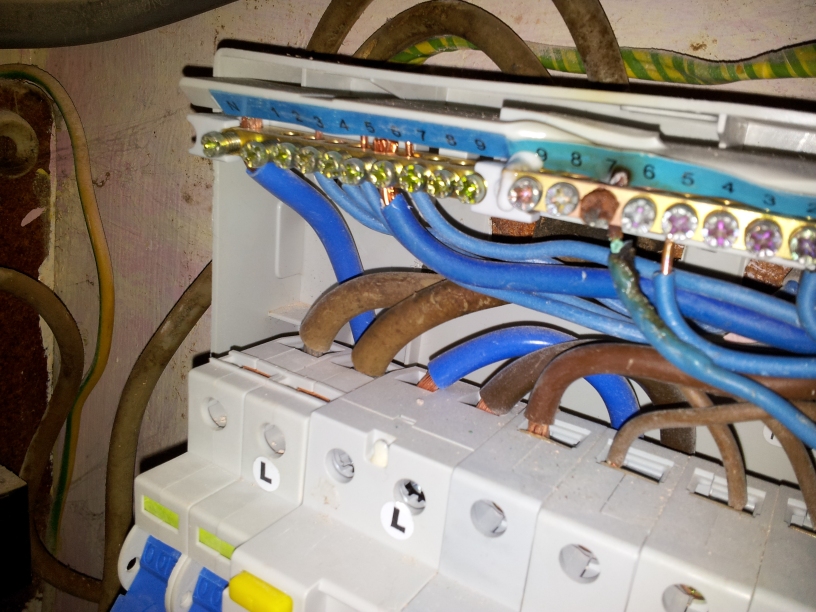

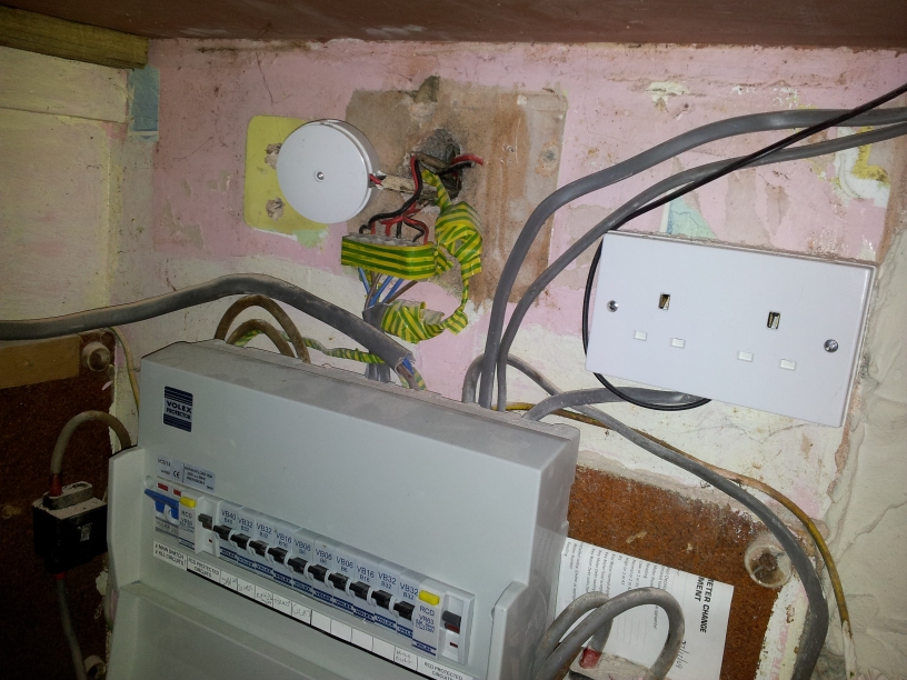

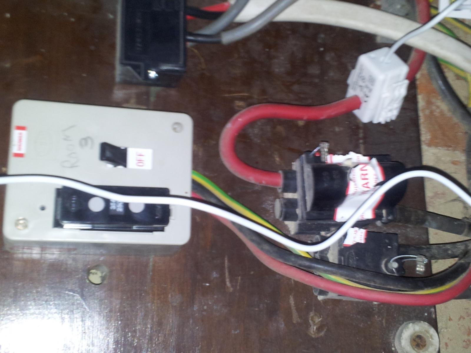

This was fitted in my brother in laws home - nice wouldn't you agree?

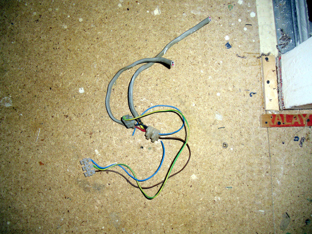

Local hotel - asked for signs removing from outside of building - I said "I can do that". Found mcb all labelled nicely and followed cable into wall and tracing visually, its an simple run so a cut at both ends and pull cable out will be easy.
I'm a bit picky though so I opened up a sign and spotted 1mm T&E. But its 1.5 Twin at the breaker. Energised and Mr Fluke Magic wand tells me its def that cable. How nice of someone to swap from twin, to twin and earth in a junction box hidden by wooden panelling. Easy how one hour becomes three. And I'm crap at joinery.

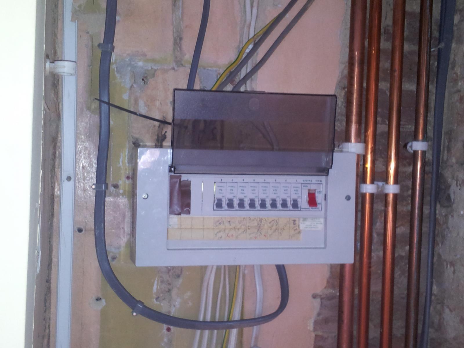

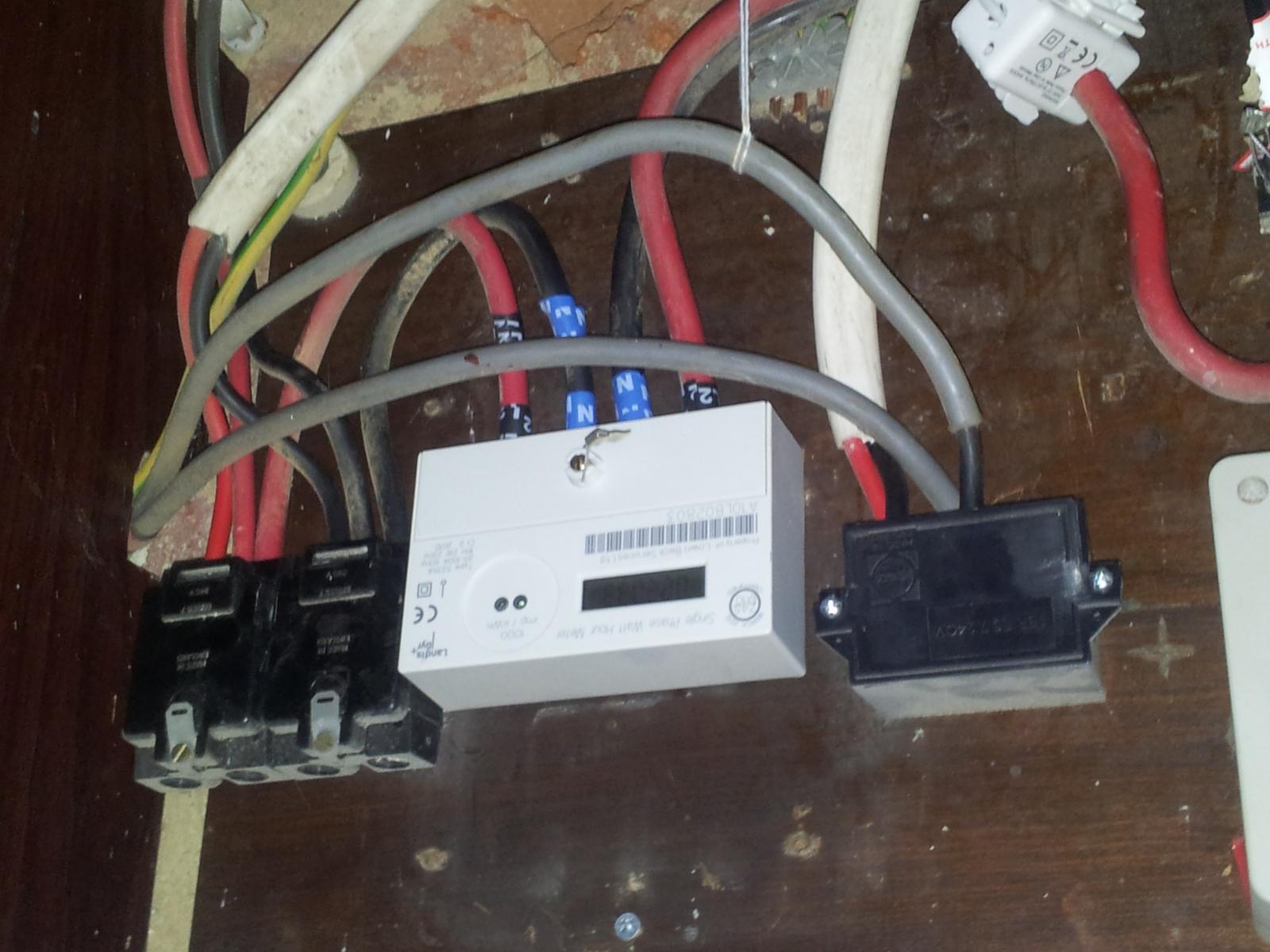

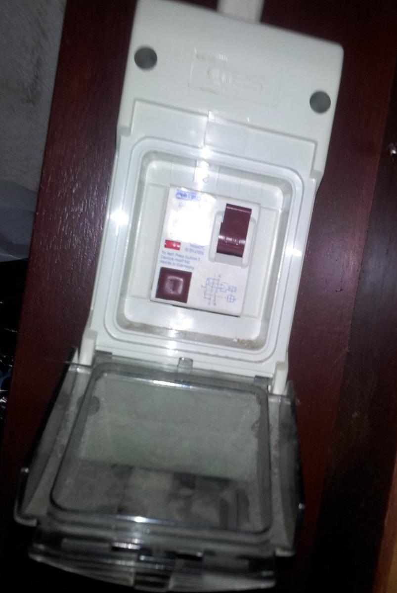

[ElectriciansForums.net] Tell us about your faults![ElectriciansForums.net] Tell us about your faults![ElectriciansForums.net] Tell us about your faults![ElectriciansForums.net] Tell us about your faults!checking some hotels recently and spotted the following. Any cables photoes are live. I like the magnetic door latch as d.b. cover.
