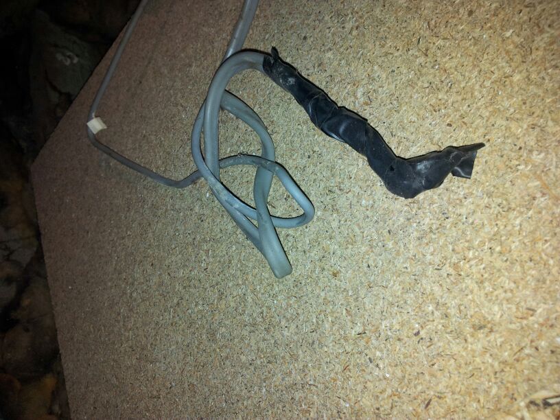

I was called to a telephone extension that was noisy and occasionally gave no dial tone when lifted. Nice simple job, just replacing a faulty voice module, but I am pretty thorough and toned the cable back to the system to check resistance of the pairs and the plug. Toning away rather happily when I found that the cable ran straight over a shower cable and a TV Coax, above a door, quite loosely hung from the ceiling, all casually rubbing together every time the door opened. The telephone cable was worn down to bare conductors and the coax was half eaten too. the shower cable was ok - but given time.......
Imagine that - phone rings so you get out of the shower, turn off the TV and answer it. Which one gets you?
