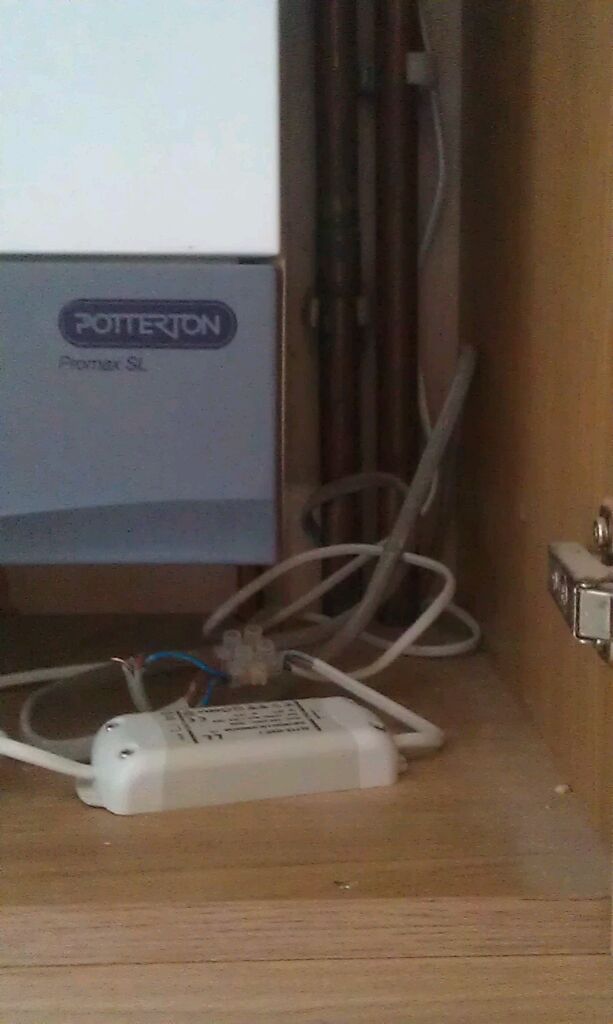

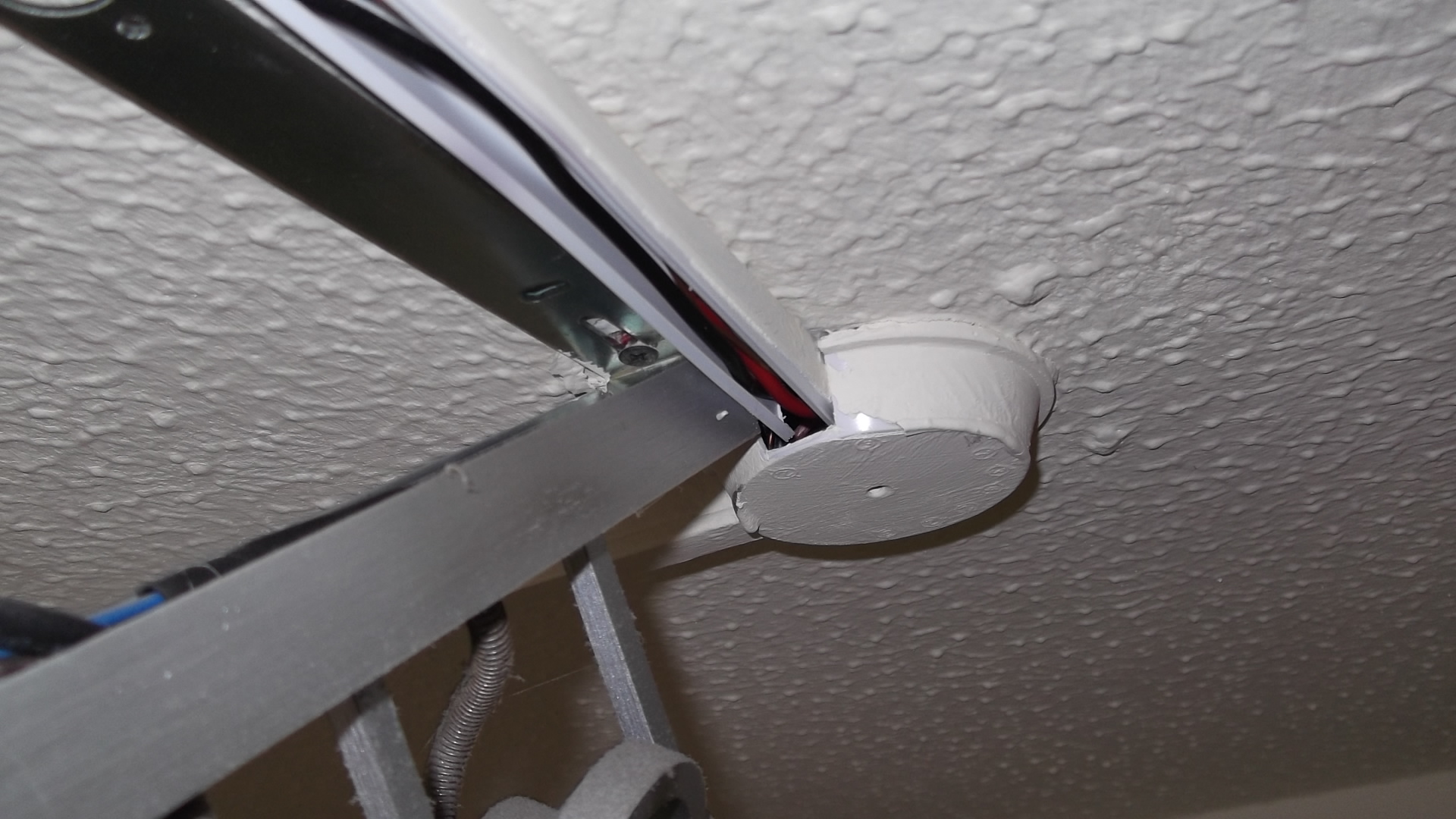

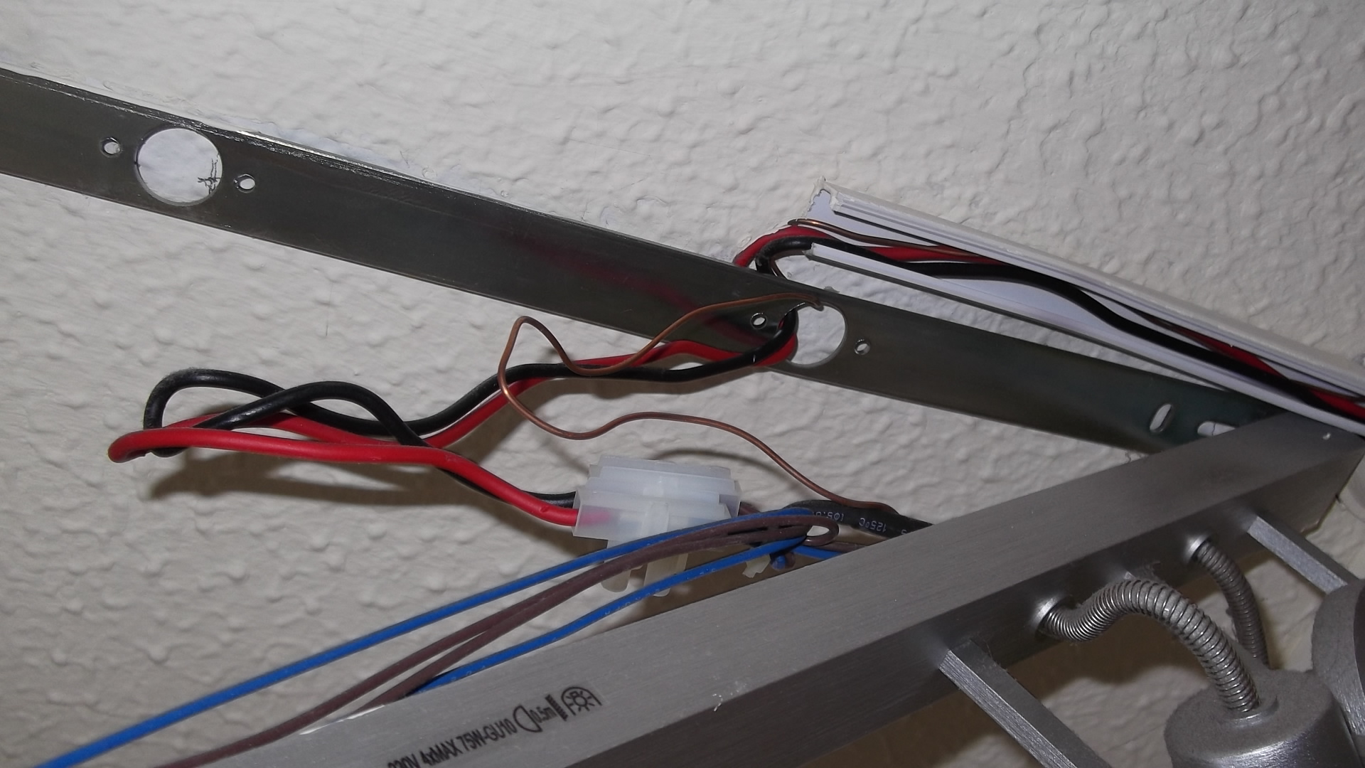

Those pics look as if they were taken before the rewire absolutely dog rough, have you showed the housing association the quality work that their contractors leave behind?
Re: Tell us about your faults !
Well yes & no. It wasn't a contractor. It was the actual housing associations full time staff. I took the original cert back to their maintenance yard to ask for the QS to be handed the report so he can review it, sign it off and return it to the householder. The guy slammed the door in my face when he noticed the NICEIC badge on my sleeve and twigged I was a sparky, saying tenants only.
So I took the cert to the headoffice a mile down the road and reported it in there. They took the certs and gave me colour copies to return to the address temporarily.
This was around this time last year, I saw my cousin back in May and he hasn't received or heard anything regarding the certs or their installation.
The whole place is a qucik fix and nothing has been done with consideration. I particularly like how they didn't bother to put the screws back in the saddles, and how the extract fan in the loft isn't ducted. This company is fairly large, I see there vans quite often round my way.
Could be a good email to NICEIC for their next assessment visit ! if thats the standard of work they want it will be intresting to see what they'd pay for a good tidy spark wouldnt it ? and just look at the ordasity of the bastedo who done it in your 2nd batch of pics in pic 14 hes even threw some tinsel down as if to say merry ******* christmas ! the greaseballs !
