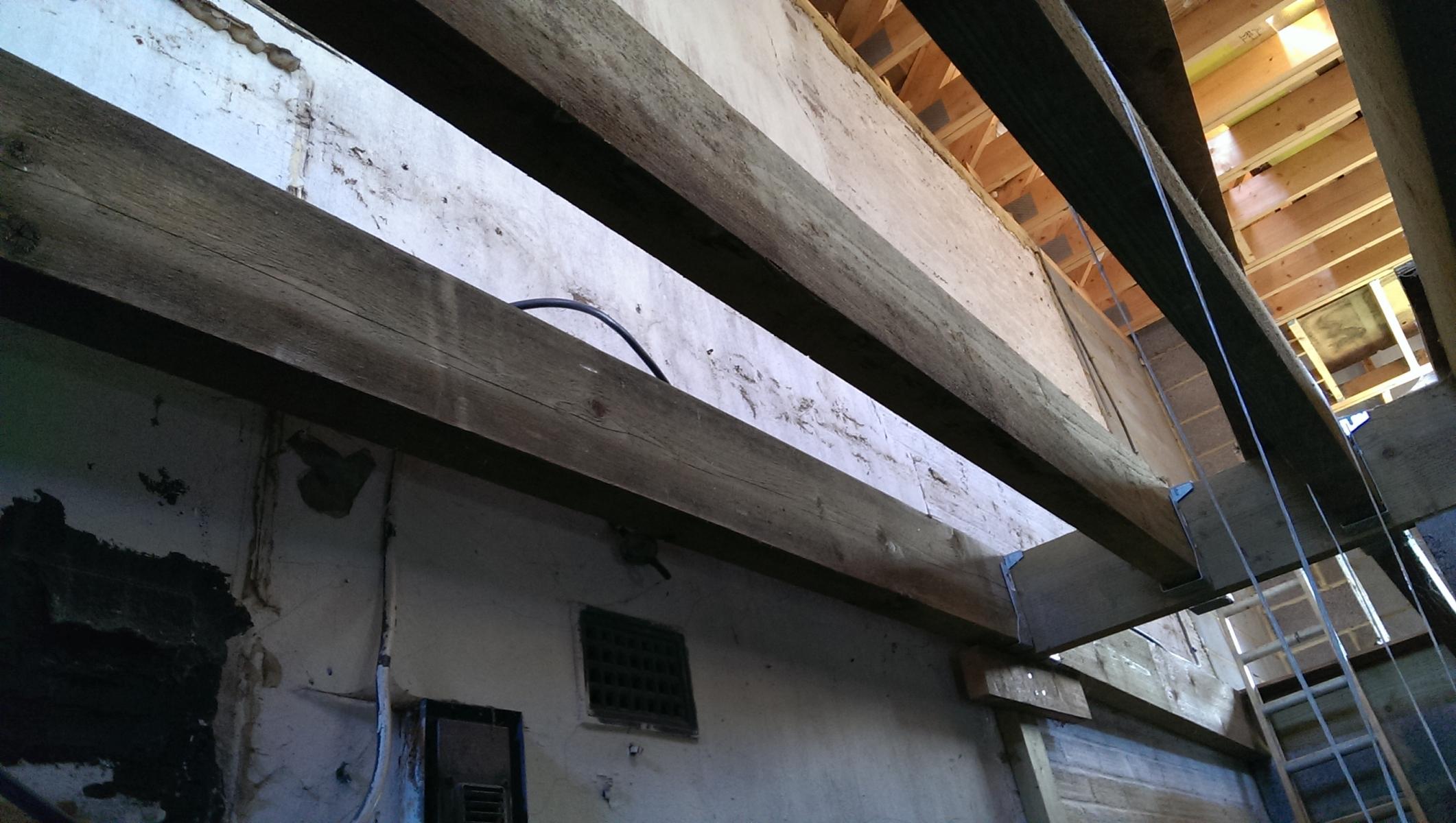

I have been rewiring a house locally origionally local authority owned but then bought by the tenants, tarted up over a few years and sold on at a profit
all the wiring looked ok, I was asked to fit a decent light in the attic, so I tested the Ze nada nowt nothing
the CU was a split load to the 16th and the incoming earth was an old braided cable, looks like the tenant rewired it himself, in the roof I found the joists were steel in pairs bolted with wooden blocks between, on top of these were laid cables and over the top of them a floor!!! you can imagine the rest
the funny thing is the incoming supply had been replaced with a new radial cable and was PME with a nice low resistance, however I told the client its a total rewire of the place will burn down, frankly I wish it had
I finally found the water stop cock hidden behind some units and a braided wire wrapped loosely around it
that was the earth??
I will post a fw pics if it lets me

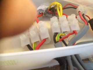

The bonding to the water in the house kept "coming away" from the clamp???
Very strange we thought! Until we questioned the owner who said....
"It affects the television reception with it connected!"
WRONG PICTURE... SORRY.... LET ME FIND THE RIGHT ONE
We connected it another couple of time, documented it on the EIC and job sheet... I'll put money on it's been removed again.. so he can watch channel 5 or whatever!!!
