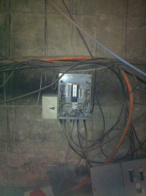

Found these beauties at a “Special School”. The company which carried out the installation went bust last year. We were too expensive for the original install but not too expensive to rewire it all….lol

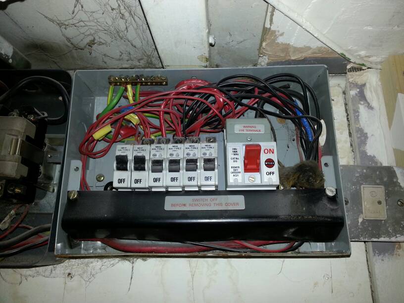

Now here's an old one.
The make is 'Revo', and the only info I can find on the web is some info dating back to the early 50's, it's certainly the oldest one I've ever come across.
Also, the twin & earth used in the ring final was blue sheathed!!!. The light was VIR singles with cloth sheath and not a cpc in sight.
Anyone have anymore info on this unit???
Cheers.
Re: Tell us about your faults !
I have seen those C/U before and yes the 50s is right, lots of council properties used them and schools and garages, not sure about the cable colouring though that is odd unless it was a local council specificiation
I have seen older than this
much much older
in the old days you had 2 consumer units on for the 5A lighting circuits with a fuse inside and an external lever like a circuit isolator and another for the 15A radial circuits
often wired in then metal tube as singles
I still have my old training manuals in the attic I might have to scan them up and post them here for a laugh, they might even be useful
I have also seen a pre war system with fuses in the neutral and live supplies and big screw in fuses horrible horrible

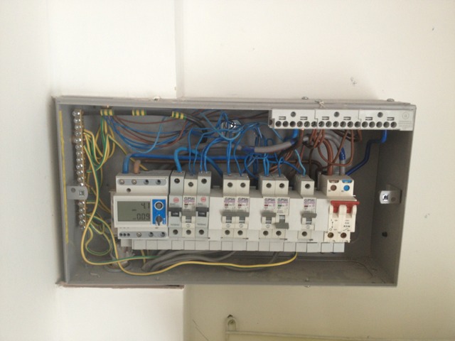

Had a good one today.
Called to a domestic property to install a switched spur in a pool plant room for a pool cover.
Try to isolate the plant room ccu, cant, even with all the (un-labbeled) mcb's off. Work out that it is fed straight from the henly blockes, via a 6mm swa that had made of into an adaptable box, with just the red and black cores coming through a 20mm hole in the box, not double insulated. The sub-main was not protected by an mcb!?!
So, i install a 2way ccu with rcd main switch and a 32amp mcb for the circuit, also put in 25mm tails and 16mm g/y from blocks.
Then i procede to carry out my tests. 0.002M ohm between Live and Neutral!! I know the must be a join somwhere because when the cable leaves it is 2 core and when it arrives at plant room its 3core. I come to the conclusion that there is proberly still i load connected. Tracing the cable back from the plant room i see it goes in to the kitchen, under the kickboards. I find a ccu behind the units, you can just about get into it.
Open it up and find what must be where my cable joins. 2core feeding the rcd main switch, with an earth which is 1.5 or 2.5 coming from the armouring (cant see it though, units in way). No swa's glanded in correctly, just stripped back.
My 3core is connected straight in the load side of thr rcd main switch, yellow core to the earth bar. Also out the load side of the rcd is a 6mm single feeding a 32amp mcb of a cooker. Again no swa's properly glanded.
Im going to re-wire a swa from the ccu installed straight to the pool plant room. Not to sure what to do with the old feed which is still supplying the cooker though???
Ive got pics but ot sure how to up-load them?? on my i-phone. DIY at it's worst.
Sorry about spelling and punctuation.
