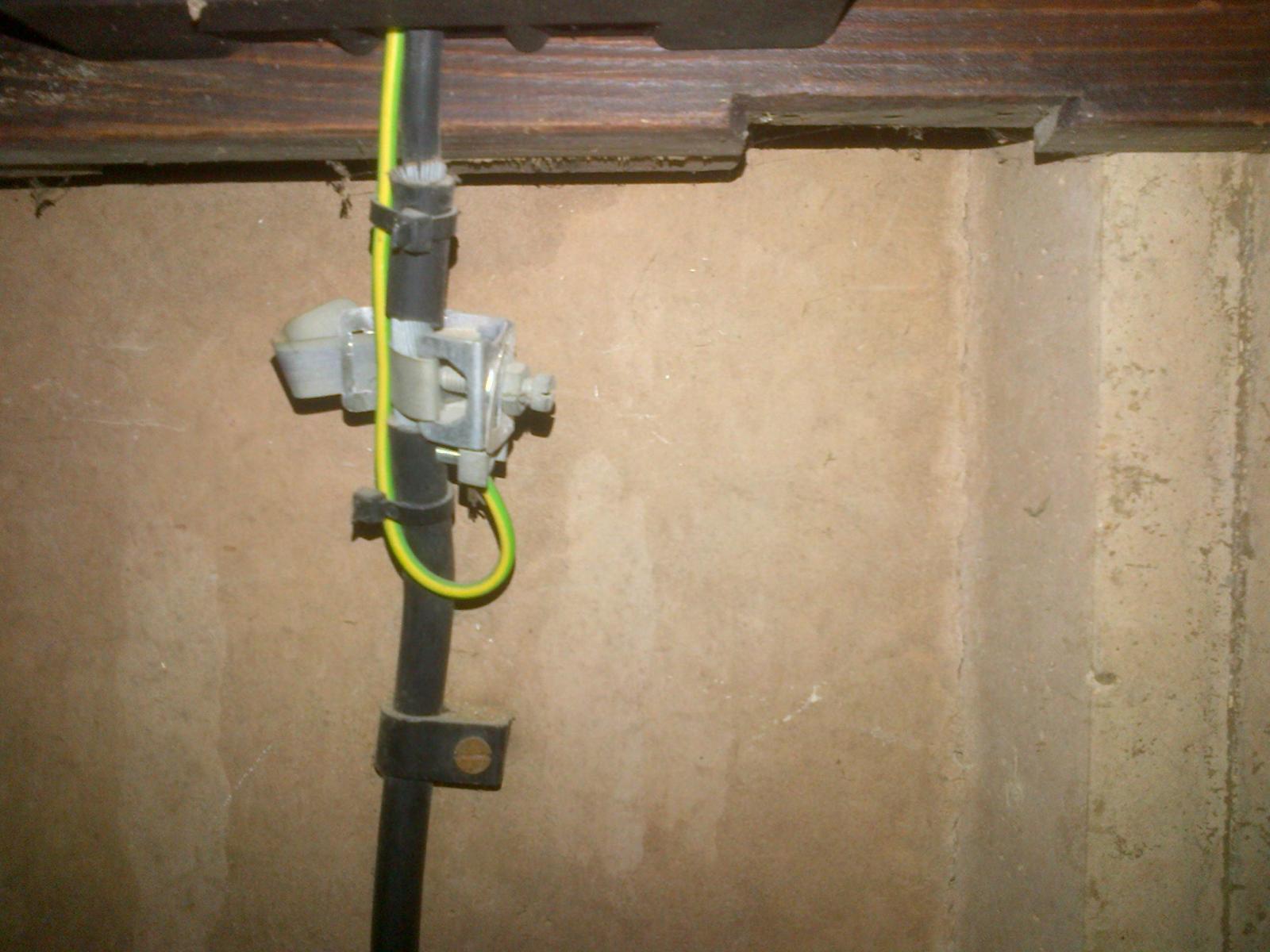

Hey all,
Was wondering if there is any reg that states an armoured cable has to have a gland both ends?
It is a 3 core single phase 10mm so has an internal earth.. ive earthed it the supply end into the board... The cable runs outside along a building then ducks back in through the wall.
The other end is to go into a small Wylex 2 way C.U. in a server room.
My problem is that the CU has a fully detatchable plastic cover, and the only entrance hole is given at the back.. giving nowhere to terminate the SWA. Even if i packed the board off the wall in wood...there would not be room to make it off properly at the back as the entrance hole is prefab.
I know manufacturers recommend proper termination using a gland.. but the armouring is earthed.. and if i hold the cable tight with cleats.. is there any reason that i cannot tape the armouring to the sheath and slot the cover over it, without a brass gland? Perhaps cable tie the top of the cable to the back of the consumer unit?
The room is locked to the public.. and i am the only person that will have anything to do with the board.
I once worked at a company where they did not gland one end of the armoured where it went into air conditioning units... cant find anywhere that actually states whether it is ok to do or not..
First time dealing with a cheap board like this so any advise apreciated..

You'd think that wouldn't you...quite common practice for me now is making off joints people can't be arsed to do.
The only time you shouldn't gland a SWA cable is in a underground joint.
There is the argument that there is nothing set in stone to say do it (if you're not using the strands as an earth) but too me, all SWA should be glanded properly in any given situation, if the environment didn't need it glanding then 100% guaranteed you don't need SWA for the job. If you don't gland SWA you look lazy/cluess and have poor workmanship.

Found this in a house garage last year
Why not use a 25mm conduit through box directly underneath the con/unit and take the cores straight through into unit, if you don't like the sight of an adaptable box. But as stated above, must have a gland fitted.
